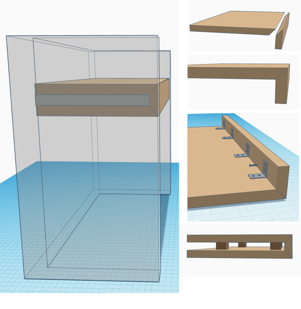

I'm sure @MikeyAllcock will chime in if necessary, but I've taken some time to create a few renderings for you on how to create the shelves mitre joint they've used. The mitre joint gives a much nicer finish to the edge instead of a functional butt joint. You'll need a circular saw, clamps and a straight edge. It would be best to do the mitre cut on a table saw, but with attention to detail, it can be done with a mitre saw. It would likely be best to use small brackets on the inside of the joint to reinforce it. If you wanted to get really fancy, you could do a double mitre, so it appears even from below that it's one thick and solid piece of timber. For the double mitre version, you'll need a timber spacer block, as you won't be able to fit reinforcement brackets.
Remember your PPE when cutting timber, including a dust mask and safety glasses.
Please have a look at the renderings and let me know if you have any questions.

@MitchellMc this is exactly what i need to do, to the point of the same measurements and material @MikeyAllcock did.
Pretty new to this but I assume the straight edge will want to be the same ( Specrite Hevea ) if that thats the case wouldn't it be better to get 600 width not the 405 to cut those straight edges?
Also the spacers are just glued on ? thanks
Re: Floating shelves
Hi @ashg79
If you are going to make the shelves with a top, bottom and front piece with two mitre joins, having more material to work with will certainly be helpful and using the wider Hevea panel makes sense as the front piece will need to be cut from the same material.
Yes, the spacer blocks can be glued in place with a wood glue of your choosing.
