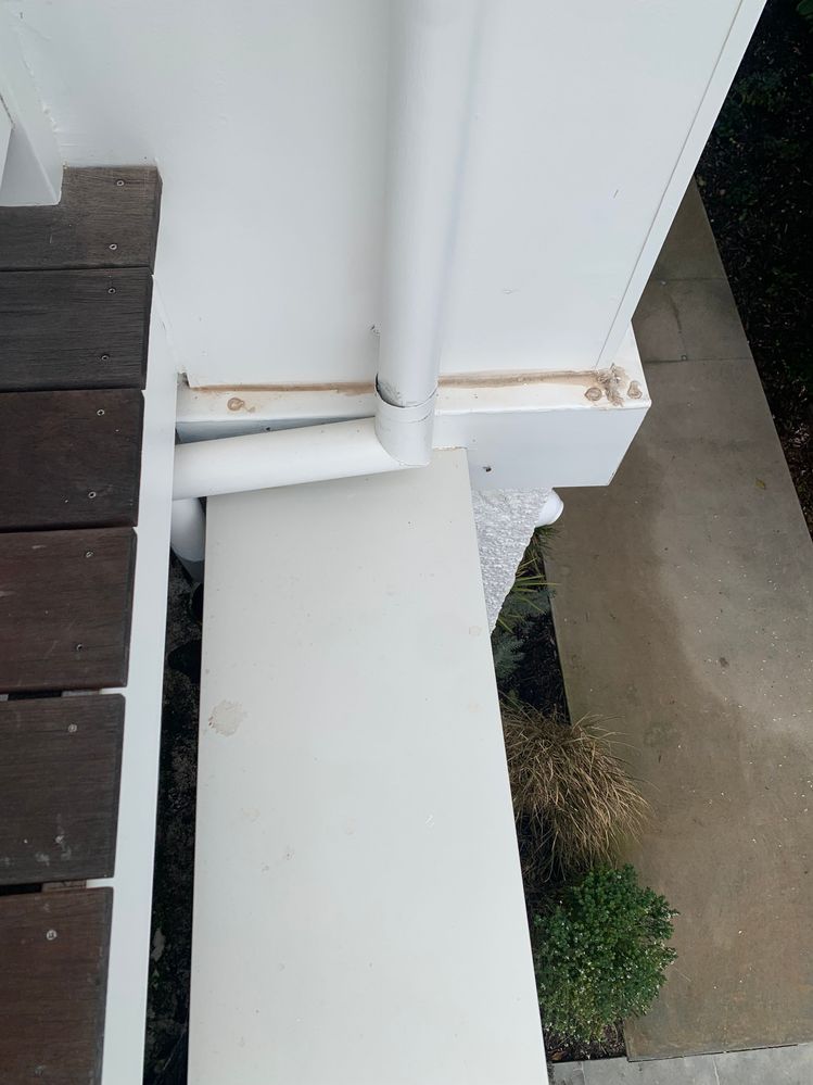

Hi this drainpipe is outside my sons bedroom and when it rains it creates a loud dripping noise.
I have in the past taken off the bottom elbow bend and glued in a sponge which has reduced the sound to a more dull thud thud thud.
I have checked the top of the drain and there is no debris stuck and I have a gutter guard above the drain pipe. I haven't tried to use a downpipe cover yet as I think it is pointless as the water hits the first elbow then freefalls to the top of the next elbow which is where the noise is coming from.
I have thought of trying to feed a chain down the downpipe but trying to get it around the elbow without removing the drain is going to be painfully hard. Is it just a bad design or is there something anyone can think of doing to alleviate the noise that I haven't already thought of?

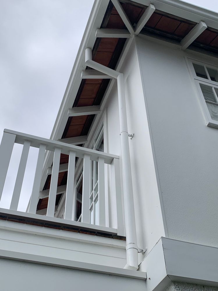

I have the same problem!
Tho with mine its a straight drip, dripping from the second story roof to the ground and then hitting the "bend" ![]()
My idea is almost the same as @JacobZ 's I was goingto suggest to use a Poly Eiger 4mm 3.6m Yellow Poly Cable Feeder and fasten one end to the side of your gutter (or tie a knot) and then feed it down the downpipe, the water would generally follow a line so it may follow the plastic strip and not fall as a drip. Less likely to clog up the pipe then a chain. I have seen the American version of a chain hanging ffrom the gutter to the ground in a vertical line and it seems to work very nicely tho dont know if its allowed in Aus?

I tried the cable feeder but unfortunately it won't bend around the first elbow to go down so I'll have to try the more expensive option of the fishing tape and / or chain

Great news, I managed to get the cable feeder down the pipe. I used an old thin butter knife down the side of the link that had a small gap to help the cable feeder around the corner . I also used a file to sharpen the end of the cable feeder to stop it from catching. Now I need it to rain to test out the theory!
