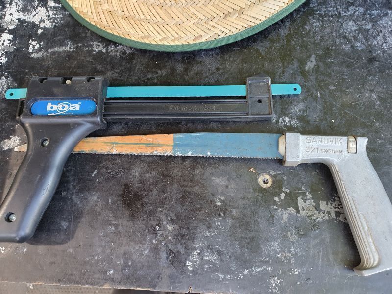

For what it's worth and should something like this happen again, I can recommend two other styles of mini-hacksaws that can be kinder on the hands and patience.
The BOA is difficult to explain in words - but it has a spring loaded arm that is in constant contact with the work and the blade is therefore unlikely to bend or snap.
The Sandvik uses a thicker and wider blade that just feels better - and you can add more force to the cut.
