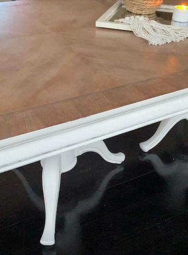

Step One: Strip the Top Layer of the veneer
As it is MD, F, I was worried about how I would strip the varnish off the table. I needed to get the top coat off, as it was pretty thick. Oven cleaner is my go-to for stripping varnish and stain. It's so easy and requires minimal heavy lifting.
Having recently used oven cleaner to strip another piece of furniture, I found keeping my finger out of the trigger challenges. So I picked up this Trigger Grip from Bunning.s
Step Two: Wash it off
You spray it on, leave it for 60 minutes and hose it off.
Step Three: Sugar Soap
I wiped the table and legs with sugar soap, ready for paint.
Step Four: Sand the tabletop
As I had to paint the edge of the table and legs (as they're MDF), I lightly hand sanded the edge of the table and legs ready for paint.
Luckily, a wood veneer was on the top of the table; II sanded the table top using an orbital sander and 80-grit sandpaper to remove the excess varnish. I had to be careful as it was fragile, and I needed to be very careful about exposing the MDF and effectively ruining the table.
Once the varnish had been removed,d I sanded again with an orbital sander, using 240 grit paper to smooth.
Step Five: Paint
Before I painted,d I wiped the table top and legs with sugar soap. I used blue tape around the edges of the the tabletop (I'm a messy painter) and painted the edge of the table and the legs.
I primed the side of the table and used a roller and brush to paint the edges, removing the blue tape before the final layer of paint had dried.
Once the legs were prime,d I sprayedtwo2 coats of top coat.
Step Six: Distress
I left the table for 48 hours for the paint to dry before I distressed the colour entirely. There is no right or wrong way to distress; it's personal taste. I like to run a course sanding pad along the corners and edges of the table and legs to remove and rough up the paint.
Step Seven: White Wash
I felt the tabletop was too yellow, and some irregular patches would only be accentuated with stain or bleaching. I wanted to lighten the to,p, so I slept on it for a few days, walked past it and stared at it for a few days,s then decided to whitewash it.
I didn't use an exact measure. I filled a takeaway container with ⅔ full of water and mixed the paintbrush I had used. Other than the brush,h I didn't add any other paint. I brushed it on in the direction of the wood and then wiped it off with a damp cloth.
I just did the one layer,r but you could add a second, then let it dry for 24 hours.s
Step Eight: Poly
I used a water-based poly; I didn't want to yellow the look with an an oil-based. I painted three coats of poly with a paintbrush and sanded with 240-grit sandpaper in between applications.
