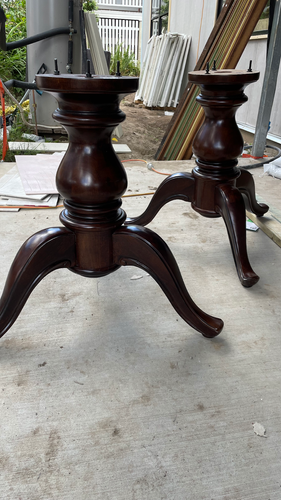

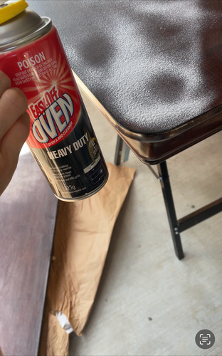

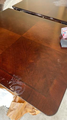

Step One: Strip the  Top Layer of the veneer
As it is MD, F, I was worried about how I would strip the varnish off the table. I needed to get the top coat off, as it was pretty thick. Oven cleaner is my go-to for stripping varnish and stain. It's so easy and requires minimal heavy lifting.
Having recently used oven cleaner to strip another piece of furniture, I found keeping my finger out of the trigger challenges. So I picked up this Trigger Grip from Bunning.s
Step Two: Wash it off
You spray it on, leave it for 60 minutes and hose it off.

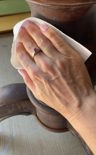

Step Three: Sugar Soap
I wiped the table and legs with sugar soap, ready for paint.

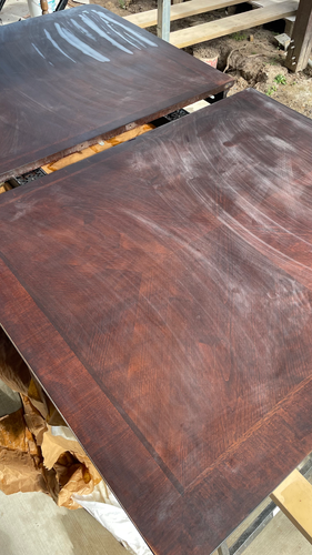

Step Four: Sand the tabletop
As I had to paint the edge of the table and legs (as they're MDF), I lightly hand sanded the edge of the table and legs ready for paint.

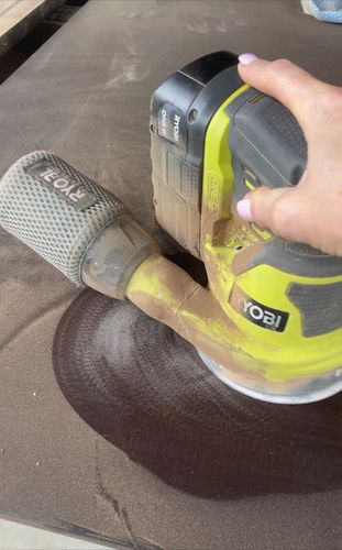

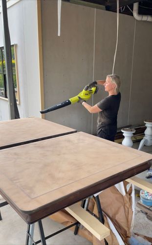

Luckily, a wood veneer was on the top of the table; II sanded the table top using an orbital sander and 80-grit sandpaper to remove the excess varnish. I had to be careful as it was fragile, and I needed to be very careful about exposing the MDF and effectively ruining the table.
Once the varnish had been removed,d I sanded again with an orbital sander, using 240 grit paper to smooth.

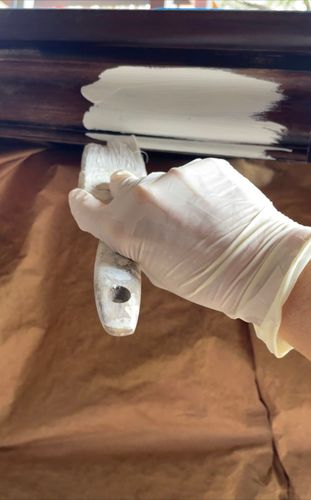

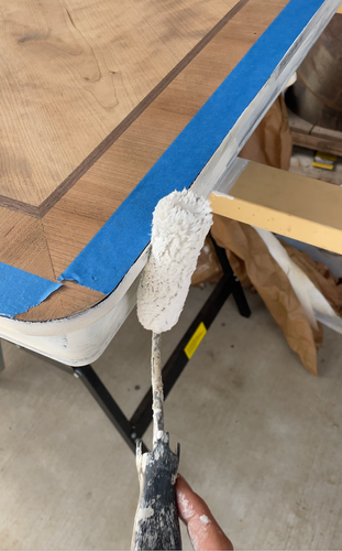

Before I painted,d I wiped the table top and legs with sugar soap. I used blue tape around the edges of the the tabletop (I'm a messy painter) and painted the edge of the table and the legs.
I primed the side of the table and used a roller and brush to paint the edges, removing the blue tape before the final layer of paint had dried.

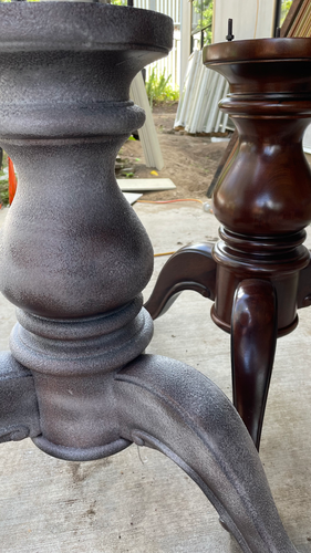

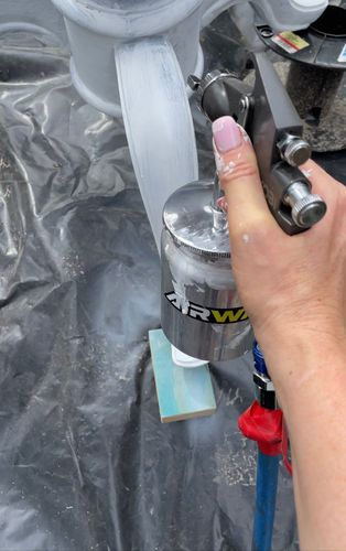

Once the legs were prime,d I sprayedtwo2 coats of top coat.

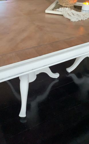

Step Six: Distress

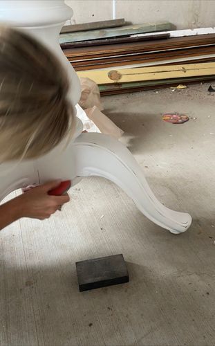

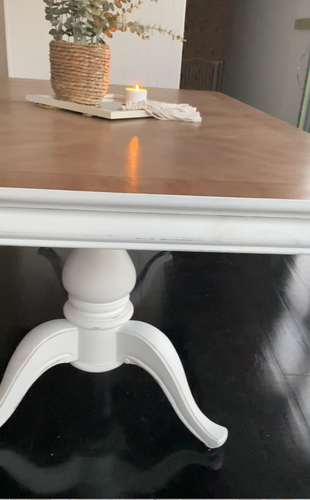

I left the table for 48 hours for the paint to dry before I distressed the colour entirely. There is no right or wrong way to distress; it's personal taste. I like to run a course sanding pad along the corners and edges of the table and legs to remove and rough up the paint.

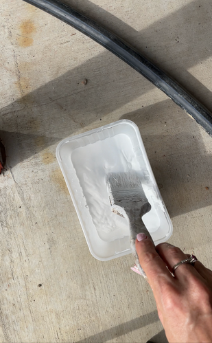

Step Seven: White Wash

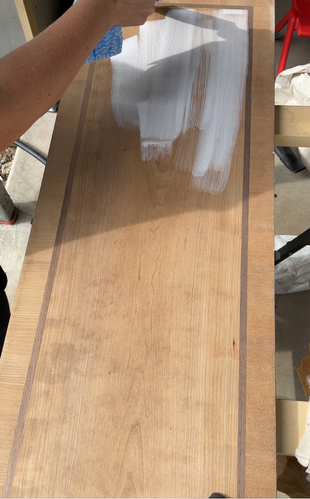

I felt the tabletop was too yellow, and some irregular patches would only be accentuated with stain or bleaching. I wanted to lighten the to,p, so I slept on it for a few days, walked past it and stared at it for a few days,s then decided to whitewash it.
I didn't use an exact measure. I filled a takeaway container with ⅔ full of water and mixed the paintbrush I had used. Other than the brush,h I didn't add any other paint. I brushed it on in the direction of the wood and then wiped it off with a damp cloth.
I just did the one layer,r but you could add a second, then let it dry for 24 hours.s
Step Eight: Poly
I used a water-based poly; I didn't want to yellow the look with an an oil-based. I painted three coats of poly with a paintbrush and sanded with 240-grit sandpaper in between applications.
That was it. It was a relatively straightforward process. I always think the most challenging part of any DIY project is the fear of how it will turn out.

As there was a thick layer of varnish I used a more course sandpaper and basically sanded until I could see the natural wood. A lot of it is trial and error and it depends on the finish. E.G a solid  wood sideboard I worked on recently only needed a 220 grit sandpaper to take the remaining varnish (after applying the oven cleaner twice) off, whereas this table required 80 grit to begin with and then once I was satisfied all of the varnish was off I finished with a 240 so give it a smooth finish. I rub my hand across to ensure the finish is smooth and also look it over to make sure there are no more varnish spots on the piece. When it came time to poly you can feel rough spots so I sand between applications using a 240 grit (orbital sander).
I used an orbital sander,  they're great I use it for most of my projects that require sanding, if you haven't sanded before don't be afraid of a power sander they're really easy to use. You don't need to apply much pressure, just make sure you don't hold it in one spot, keep moving up and down or side to side, or you will take too much off one area.

Thanks so much! it's actually really easy to do, I honestly think the hardest part of any DIY is the unknown. You can't really go wrong, if you don't like the look you can always repaint it. My tip is to run your sander around sectons the corners and hard edges - you don't want to distress every corner or edge as it will look too perfect. If you do it gradually and keep stepping back to see how it looks you will avoid over distressing.
the whole point is that it's not perfect - which is why I love distressed furniture. Hope that helps, I'd love to see pics of your first project :smile:
