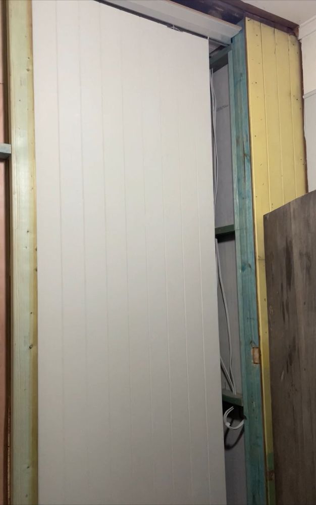

Thank you so much for sharing your door assembly process. The door looks fantastic, and it would probably have cost you an arm and a leg to have this made. It's great that you had some left-over materials to build it, what is the overall thickness of the door?
Again, thanks for sharing this fantastic project.
Re: DIY Pocket Door: Queenslander Renovation
Hi @EricL Thank you so much, love how it turned out and loving the savings you're right it would have cost a fortune.
The door is 40mm thick.
Afternoon @Renowayoflife
Now that is a brilliant idea! First up I really like the seperation if needed and then such an imposing door but hidden :smile: Nice work and definently outside the box thinking. Think I will file this away for possible future use :smile:
Thanks @Dave-1 It's great as it retracts entirely into the wall so most people don't know it's there :smile:
We have 3 small kids so it's great if you're up early you don't wake everyone up.

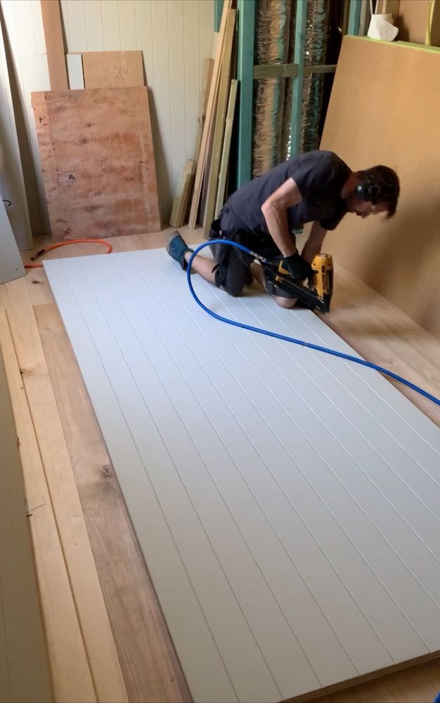

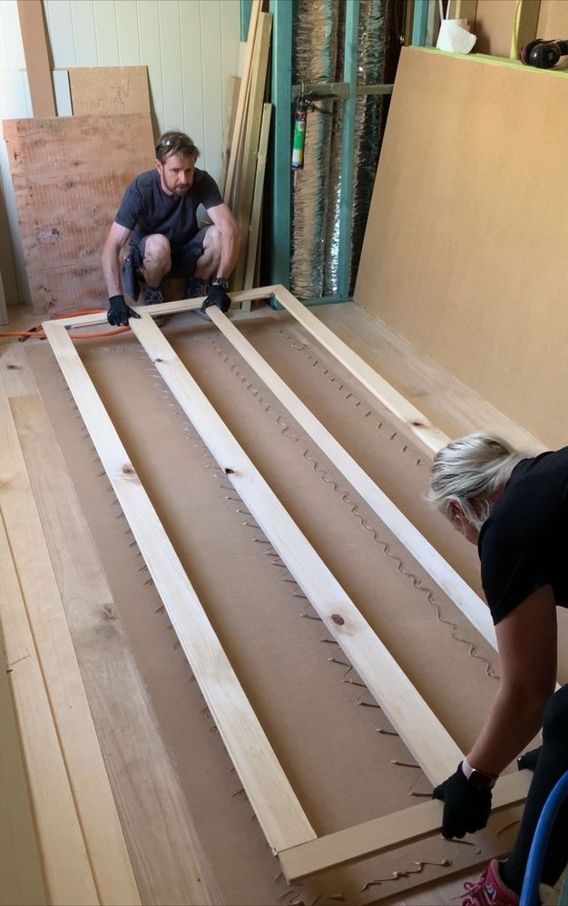

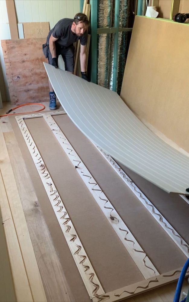

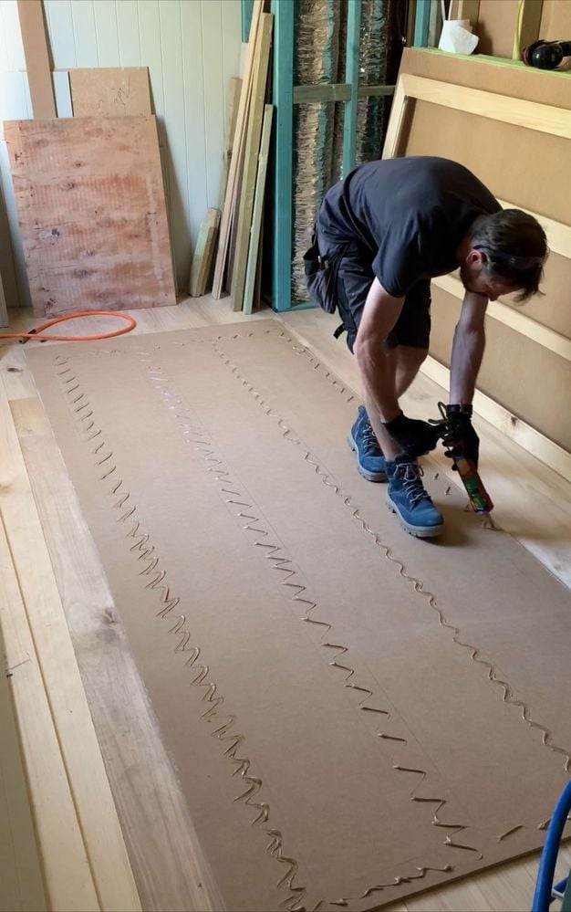

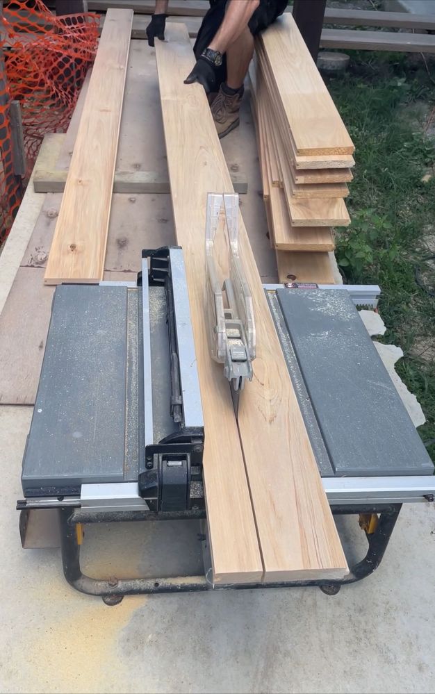

We didn't need a lot of tools for this project, we used;
  • Circular Saw to cut the pine frame and VJ's down
  • Nailgun 15 gauge to nail it into place
  • Orbital Sander to sand after filling the holes
  • Framing Nailer for the frame install
  • Screwdrivers for the frame.
