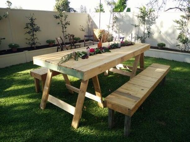

D.I.Y. table made from four pallets
You can get full instructions for building this table here - How to build a pallet timber table

I hope you don’t mind me jumping in here @Peggers but @WCE2019 It’s not a silly question at all it really comes down to what pallets you have available to choose from.you could definitely build a table similar to this one out of 2 pallets if you had two really long pallets e.g. 2.2m long or longer . If you can find them then you could use 1 as a donor pallet to get enough timber for what you need.
Here is a couple of tables I built using only 2 pallets. Different style I know but you could always cut the planks and flip them sideways if you want the same look as @Peggers table.
if you can only get your hands on standard short pallets 1165 x 1160 well in WA that is then it could still be done it just wouldn’t be as long or possibly as wide.
I hope that helps a little bit

@Yorky88 Your table is AMAZING! Love it!!

Cheers @Peggers it honestly was one of the simplest builds I have ever done but still just as effective. I appreciate the feedback though 👍🏻🙌🏻

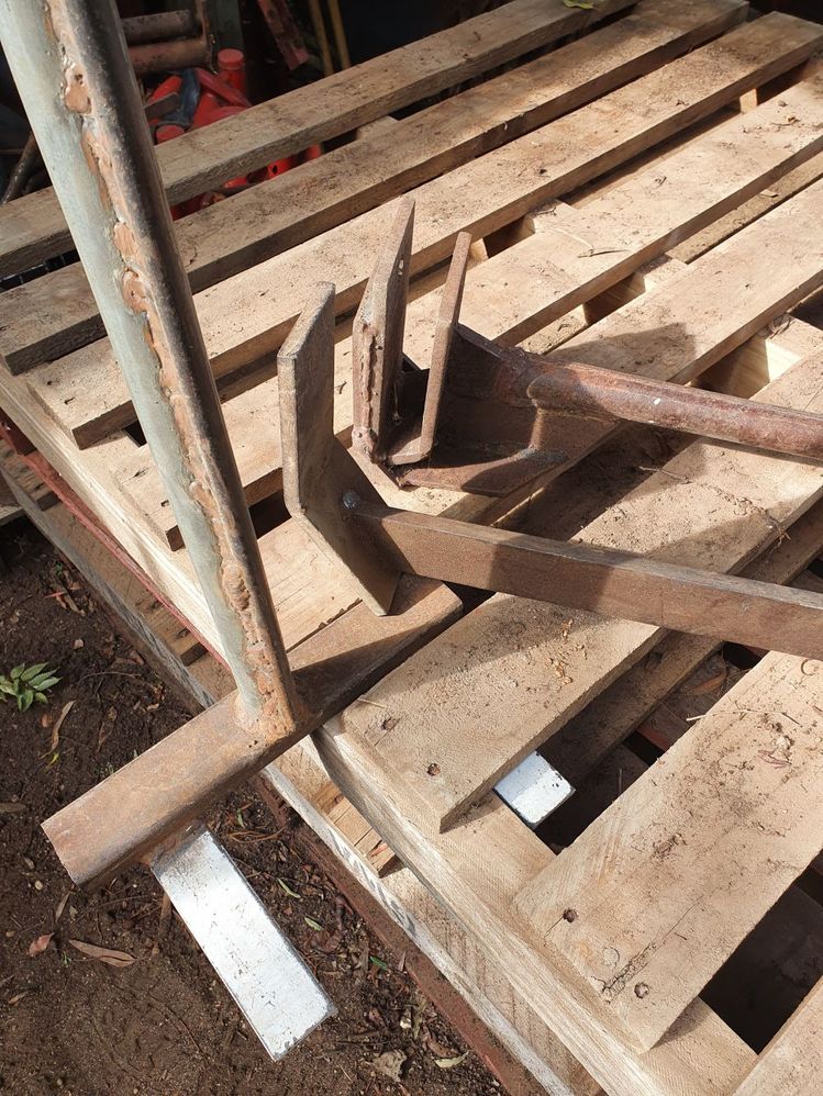

"However some pallets are a lot harder than others depending on what type you pick up."
I'm not sure if it's geographical but the pallets I pick up seem to be built to last forever. Some I've found are put together with 100mm nails that have a corrugated body which makes a clean withdrawal impossible. Sometimes the wood will tear away from the nail head leaving a gaping hole or the wood simply shatters.
Then there some pallets that fall apart just by looking at them. I don't find many of those.
I tried a Mumme "Pallet Breaker" (Bunnings $89) and despite being made of spring steel, I bent a fork on the very first attempt on a hardwood pallet.
I rang the company and was told "there are some very tough pallets out there" - and suggested I return it for a refund. I did.
I watched some YouTube and these are the breaking/prying devices I came with (that don't bend).
Closest works the best - the furthest is for when it's time give up and destroy the pallet - firebucket food.
Pallet BreakersPallet Breakers
