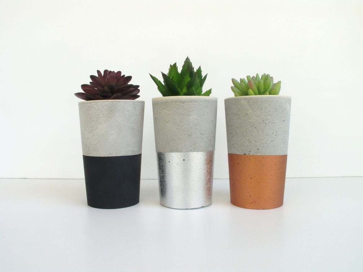

Wow - these are awesome! I might give this project a crack myself. Thanks for the insructions!
I would try painting with a metallic finish. It would complement the industrial feel quite nicely. Maybe a small stripe down the base? I've just done a qick Google and it looks like someone has just done that - and it looks great!

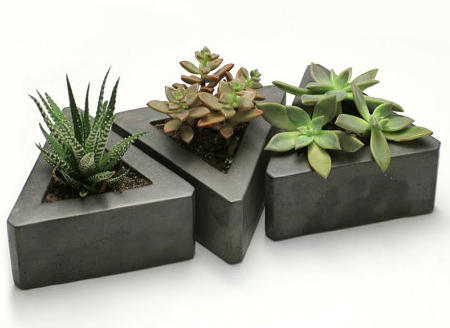

Saw these triangular concrete vases on etsy. I think they are beautiful. Not sure what I could use for a triangular mould though...
