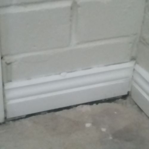

I'm having a carpet laid on top of the concrete floor in my unit. But first I want to fill the huge gaps between the skirting board and the floor. What is the best budget product for this job, please? My DIY skill level is "newbie" 😕

This Parfix gap filler will certainly do the job @ShelleyBean, and on a budget as requested.
Out of curiosity, why do you want to fill it in the first pace given it's going to be covered by the carpet? Is the gap that big you're worried it'll still be visible once the carpet is in?

Do I need anything else to make this work? Like a nozzle or a plunger for application?
My main reason for wanting to fill the gap is to stop the beasties from getting in! 🐜🕷

You just need a caulking gun and the nozzles are free (if not already attached to the filler, the person at checkout will give you one (ask for two)). You'll need a knife or scissors to cut the end of the nozzle to give a decent sized opening.
Squeeze a generous amount of filler into the gap and smooth it off with your finger (wet it first (saliva or water)), then wipe up any that gets onto the skirting. Nice and easy.
