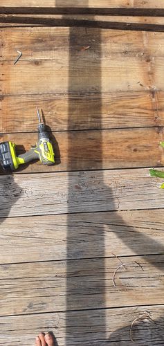

I have a timber staircase with a lot of cracks on it. A friend of mine just mentioned it needs an urgent repair. What's your thoughts?
If I need to repair it, what should I do?

Are there any sections of the timber that feel soft? If you take a flathead screwdriver and poke around the top of the tread, does it sink into the timber easily? Does the structure feel weakened?
From the photos you've provided, I don't think there are any immediate concerns, however, these splits along the grain of the timber may allow water to get inside the timber which can cause rot over time. If there is rotting, you may need to consider replacing the stair treads.

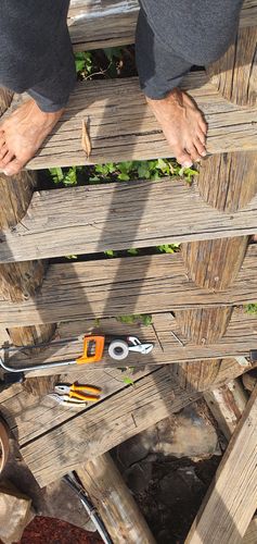

From those two photos It dosnt look like it needs fixing anytime soon. Could you take some more photos of where the timber treads touch the sides and an overall photo?
As @JacobZ mentions over time timber does this, water can get into it but no real concen. Those treads look like they have been there awhile and still going strong. Do the treads flex when you walk on them? And is there anywhere that the timber is softish that you can push a screwdriver easily into it?

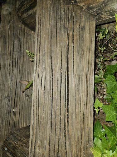

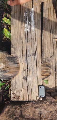

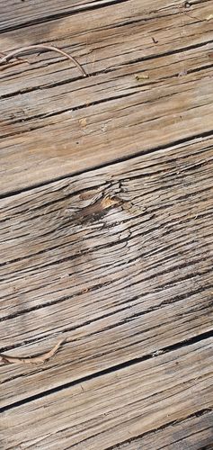

My father didn't wait till I get a solution here and started overturning the treads 😂😂😂 the other side is in a pretty good condition.
 however, below is more photos. Also, I couldn't find/see and soft area
Still seeking your advice
Thanks
Sam
Re: How to repair cracks in timber staircase?
Afternoon @Samnet
Id be very happy with them as they are :smile:
The treads look like hardwood and dont look like there is any rot involved. The supports look good as well.
So apart from cosmetics I think they are great. With your father turning them over all I would suggest is a few coats of decking oil and they will be great for a bunch more years :smile:

As @Dave-1 has said, they actually look to be in really good condition, but a good clean with Cabot's Deck Clean and few coats of a clear decking oil such as Timber Protect Water Based Exterior Decking Oil or Cabots Aquadeck Natural Exterior Decking Oil would go a long way in protecting them and keeping them looking good.

Ditto on both @JacobZ and @Dave-1 there is no concern of the timber deteriorating other than simply aging. the only concern would be splinters on bare feet, which can be easily rectified with sanding and sealing with a decking oil.
