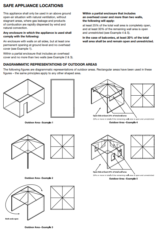

my cabin is very basic and the kitchen area is on an open deck so fumes are not a problem   However I would prefer not to have the LPG bottle on the deck.
Re: How to connect Gasmate two burner camping stove to regular 9kg lpg bottle?
That's great to hear, @ashmoreavenue, as your safety is our number one priority.
Provided your deck area complies with the requirements below, a Gasmate Adaptor - LCC27 to 3/8" BSPP LH can be used to adapt an LCC27 gas cylinder (new type with external thread) and allows you to connect a camping stove hose.
