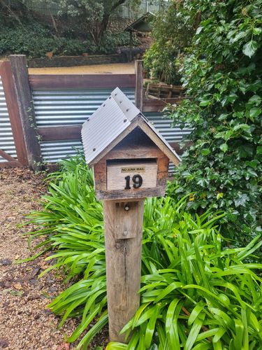

Hi, I'm looking to make a similar postbox to this. Simple, wooden and one where the slot is big enough to recieve an A4 letter.
I am a complete novice with basic tools so the simpler the better.

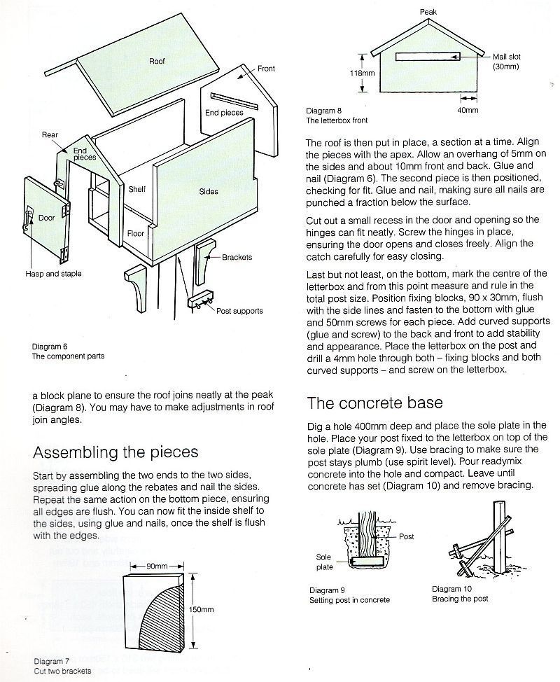

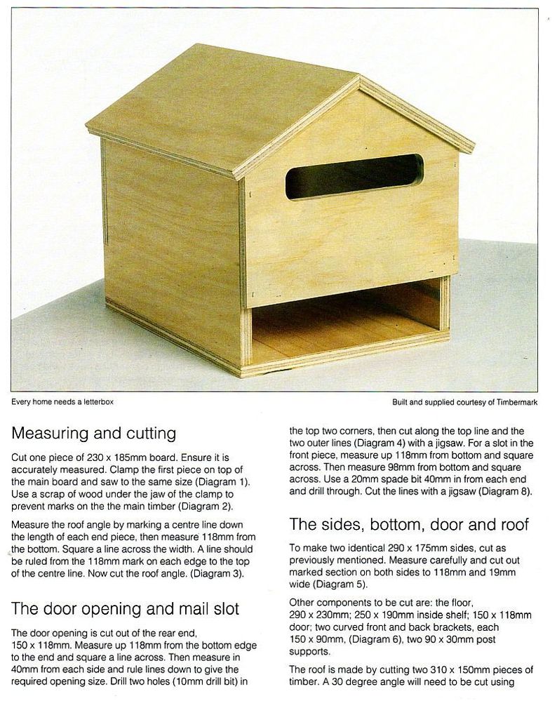

Evening @philipmkeane and @MitchellMc
This one is courtesy of 'The Australian Handyman' from 1994...
