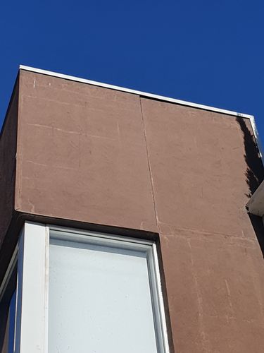

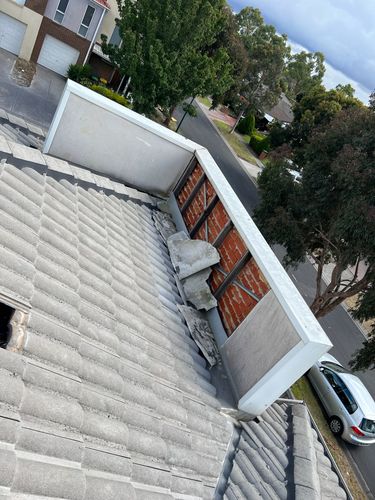

I have the roof installed and roof man found out that part(it looks like a cement on brick wall).
It causes water leaks and gaps around window frams inside and inside wall has dampness.

When I had the roof done, it was not included in quote. Roof man took photo of theis back of the wall on the roof and informed me to fix it. I don't know which trade I need to get quotes from.

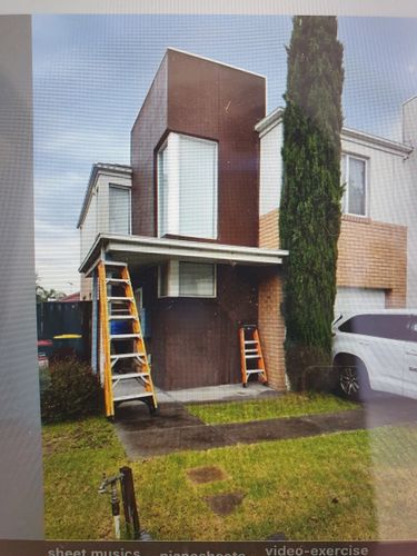

OK, thank you @mia2. I'd imagine any general tradesperson could complete the repair for you, but could you please take a photo of the other side for us? It might help to explain what we are looking at. Then our members would be in a better position to suggest next steps.

Id suggest a builder to repair it. You could also do ityourself if you are confidant of cutting a sheet af hardiplank. If you are concerned about working at heights and cutting the sheet then a general builder for sure.
