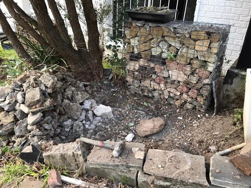

I like your Oomph for the job :smile: Tho I have tried the same thing to break up much thicker piece of concrete pathway beside my house. I did a bunch of holes through the concrete and still it didnt break. I have used a wooden handled sledge hammer but ended going with a firbreglass handle and that made it a lot easier on my arms/wrists.
My best suggestion is actually to use a pound hammer IRWIN 3lb Club Hammer Think of it as a shorter sledge hammer, musch easier to sit on the ground and bash away. The pound hammer (just the name I know it as) has a rounded/poined side and a flat side. Both work but the rounded side puts more force into cracking the concrete. I have used it to break up the majority of my concrete for my gabion walls and by no means am I fit or strong.
One of the rock piles i have...

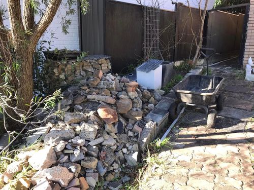

The "Pound hammer" This one is a trojan named brand from Bunnings and seriously a good tool, cheaper then the one I showed in the link. Same shape, same job :smile: I have been sitting there and "belting the concrete and rocks, sometimes placing them so they sit between two rocks so it is easier to break them up.
NOTE Saftey specs are a MUST :smile: You will thank them for sure.
You could try it before investing in a machine plus tools to break up the concrete. However if you still dont feel up to the task I would suggest to hire an electric jackhammer for the smallish area you want to do. Cheaper and the machine is built to do that job. BTW the jackhammer will weigh more then a sledgehammer. 😕
