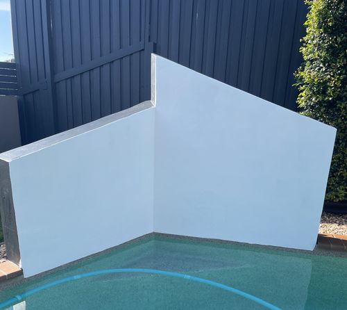

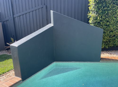

So I finally took the 'plunge' and got into the pool lol 😁
I scraped off the chalking paint, gave the wall a good sanding, brush, and washed the wall with Selleys sugar soap.
Once dry, I applied the surplus paint I have: two coats of Dulux undercoat (1Step Prep Primer, Sealer & Undercoat) followed by two coats of British Paint (4 Seasons exterior low sheen).
The result looks great, particularly given the paint colour matches the fence in the background (as mentioned in an earlier post, the British Paint was colour matched by Bunnings's paint matching service).
Now to see how long it stays that way - I'll provide an update in a year or so.
