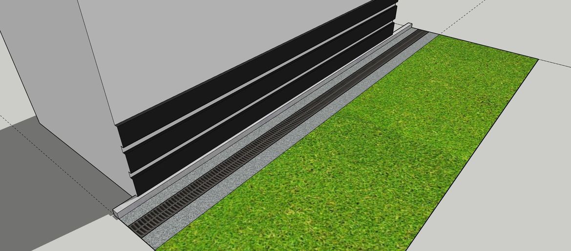

Hi @KeithNeely
I totally understand your worry on the flow of water. I've re-drawn the channel drain so that you'll have a better idea of how it works. Should your lawn area get fully soaked, any excess water will begin to overflow towards the channel. You'll see that the concrete has a little kickstand at the end to protect your barge boards.
Thanks Eric, your drawing has made it very clear now, cheers Neil
