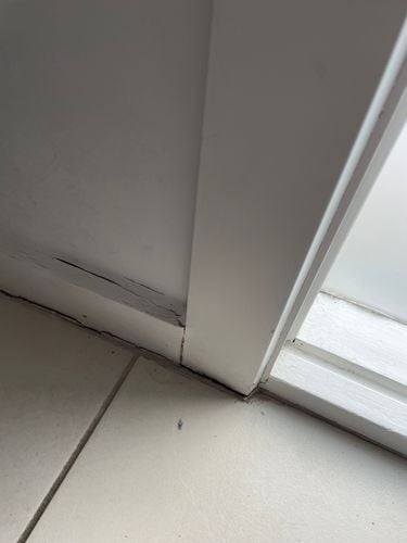

I have an issue with the front door step of my house. There is humidity coming through inside the house near the front door and I think it's because the door step is not waterproof.
Can you please advise? (last photo is the humidity inside).

It looks like the bottom of your door frame has timber rot damage on it. Would it be possible for you to post a photo of that bottom corner of the door frame. Does the folding weather seal still work when the door closes? Is the other side of the bottom of the door frame rotting as well?
I suspect that water is entering through the corners of your door and settling in on the sides. I believe that the first thing you should try to repair is your doors weather seal at the bottom. You can then turn your attention to repairing the gap fillers that have been damaged.

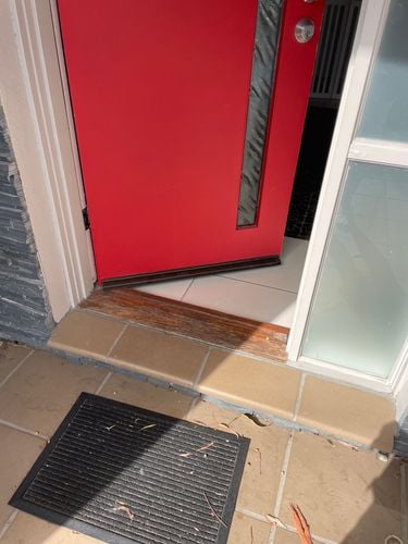

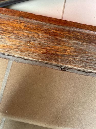

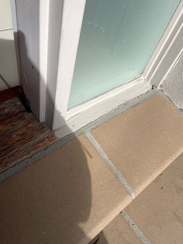

thanks, I think the Raven is not damaged. However, I think the issue comes from the exterior. There is worn out sealant between the tiles and the wooden part. What product is that please?

I'd tend to agree with you that water is penetrating the frame through that crack in the grouting between the tiles and timber. A flexible sealer should be used here instead of rigid grout.
As a band-aid solution, you can dig the debris out of that crack and try to open it up with a flat-head screwdriver. Chip all that very thin layer of grout away. You'll find it breaks away very easily. Once you've opened the crack up to around 5mm, caulk Sika 310ml Grey Concrete Sikaflex Pro+ Polyurethane Sealant into the crack and smooth it off with your finger covered in soapy water. You want a nice transfer from the grout to the timberwork.
Ideally, it would be best to cut the grout out, open up the joint fully, and then fill it back up with the Sika product. However, the main concern at the moment is closing that crack up and stopping water penetration.
After you've sealed the crack in the grout, take Selleys 430g White No More Gaps Exterior Gap Filler and fill around the bottom of all the timber and window glass on the exterior. There are several smaller gaps that water could also be penetrating. Be very careful when working around the glass, and ensure you do not knock it. Wear appropriate PPE when working around the glass, including safety glass, gloves, a long-sleeved shirt and trousers and enclosed footwear.

Also, as @EricL mentioned, make sure your door seal closes hard against the timber when the door is closed. Check that there are no gaps under the seal. There's a timber lip on the inside of the threshold, and I suspect the seal might have been installed too high to stop it from fouling on it. If installed too high, it won't seal properly when the door is closed.
