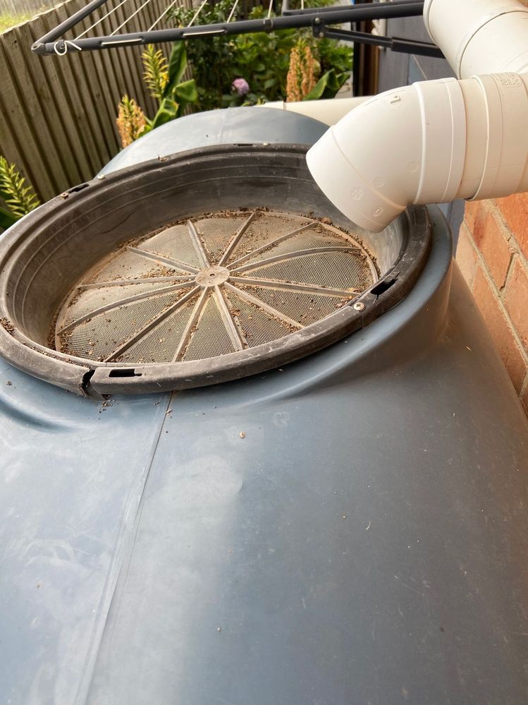

I don't see any way to open the tank. Will try to share a photo...
Re: Surphur smell from water tank
This is the only opening. So I should unscrew this screen and leave it open for a few days?
I am having the same problem with my water tank, I have the same screen top that I can unscrew, but if I remove it to let the air in then I won't have a filter before the rain water pour into the tank, then ai will definitely have stuffs getting into the tank......what is the best way of doing it? Thanks
