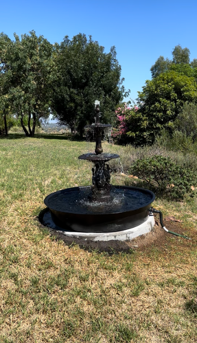

Concrete slab: dug circular hole 12cm deep and 20cm larger in diameter than basin.  Spread road base on bottom.  Levelled and tamped. Used thick plastic garden edging and stakes to make form.  Mixed concrete with shovel in wheelbarrow (wish I had a mixer!).  Floated and troweled to smooth finish.  Basin and fountain installed once slab cured for about a week.  Pump installed and connected to fountain. Solar cabling run inside water pipe and buried underground.

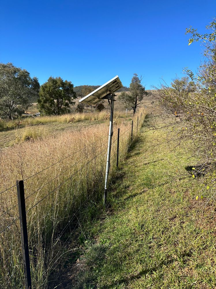

Solar panel mount: dug hole and steel post concreted in. Used 20mm square steel tubing and corner brackets to make frames to hold solar panels (screwed on).  Attached to steel post with recycled satellite dish adjustable angle clamp and adjusted angle for optimal solar input

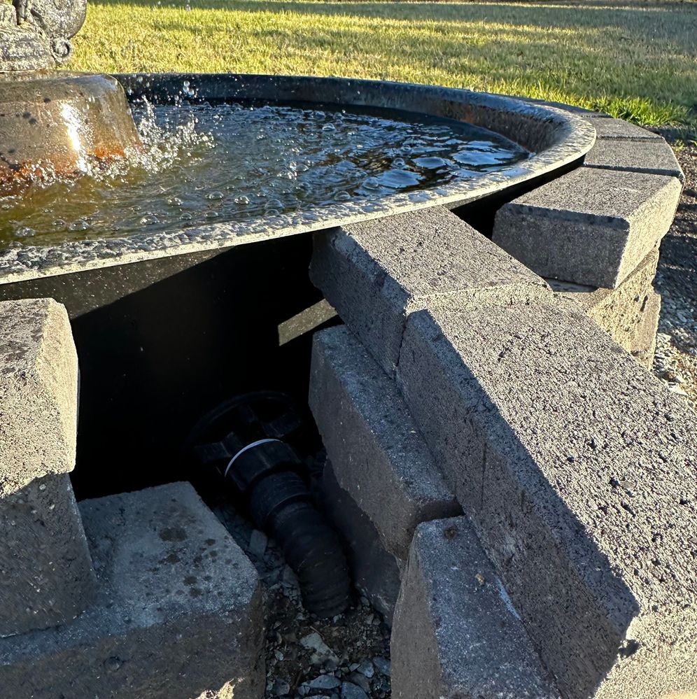

Surrounds: laid and levelled first row of blocks then glued second row on using Selley’s landscape adhesive.  Used pavers for top row, glued on using Selley’s landscape adhesive.  Used cold chisel and hammer to cut last blocks to size and make a removable section to allow access to cabling.

How classy does your fountain look! I have been looking at bird baths, fountains even small ponds for years but this one is the nicest one I have seen. I really like how you have hidden the solar panel away from the fountain itself. Where did you get the base container?
Really adds character to your yard.
Re: Solar-powered water feature
Thanks.
Got the basin at The Garden Shed (thegardenshedtamworth.com); they sell the fountain too but got mine online as they didn’t have it in stock.
