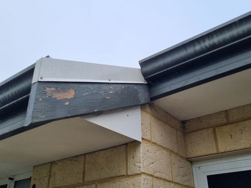

* The fascia is also Al, but there are some timber edges, As shown in photo below. Would you use the same paint?

I dont know if you need to sand the surface or sugar soap it and will bow out to someone that knows more then myself on that. Tho for the timber I am currently stripping back my front door because of that type of issue. For your Facia I would sand it back so you cant feel the paintline between the timber and wood then undercoat (or at least two-three coats) of the paint you use for the rest over it.
Do you know the state of the inside of tyour gutters? As in, is their rust ect inside? Whatever paint id use (and yeah I would go to Bunnings paint counter ) Id prob choose a medium and a small brush to apply the paint.

@Dave-1 is spot on when he mentioned that there are different paints for timber and metal. A good primer to use would be the White Knight Rust Guard Grey Quick Dry True Bite Primer Paint in combination with the White Knight Rust Guard Topcoat. This paint system will work with your fascia as well.
A single coat of primer is often enough to prepare the surface for painting. A minimum of two coats is recommended for the topcoat.
As for the timber part of your roofing, the exterior paint you are using for your door should be sufficient to use. Please remember to sand the surface of the timber you are repainting.
