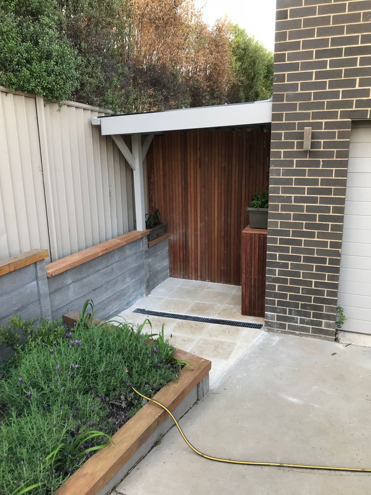

Hi All, I had to post and share - finally finished the side access to my house (but still have the other side to do!). Am stoked it’s now done. A big job that tested a range of skills - plumbing (basic stormwater drainage), concreting, paving, retaining walls, pergola, screened fence and gate, screened gas meter and some plants for good measure. The pergola serves as a shed (about 6.5m in length). The gate can be secured. Happy to pass on the lessons I learnt. Am enjoying a cold one tonight. 03F48243-0659-4D1D-BEAE-4B06C9176A97.jpeg

Wondering - what is the best way/product to fix the sleepers on top?  And would it be suitable to sit on, or just more of a bench or aesthetic solution?  Thank you !

Hi @jodee-bee if it was timber it's easy enough to screw them down using long bugle-batten landscape screws but as it appears they are concrete sleepers you'd need to use a suitable landscape-grade construction adhesive.
If properly fixed this way they should be suitable as a light-duty bench-seat.

I secured the timber sleepers to the concrete sleepers using galvanised masonry anchors (2 per sleeper). I drilled through through the timber sleeper and then drilled corresponding holes into the sleeper. I was careful not to make the hole too much of a tight fit for the anchor as I didn’t want to risk cracking the sleeper as I fastened it in (with a socket wrench). It worked well - no cracking, even after a couple of years. They are stable and can be walked on, which I often do to cut the hedge you can see above the fence. I also applied a small bead of silicone around the top of the hole as the anchor’s were fastened in, just to provide some protection against moisture getting to the sleeper’s internal reinforcement bars. The other option is to glue them down as per @Adam_W @‘s suggestion. This would work too and I did think of it at the time. I went with the anchor screw as I thought it might make it easier to remove/replace the wooden sleeper if and when I needed to. Hope that helps.

And yes, masonry anchors can work well in such situations but personally I'd avoid any of the 'expanding' type bolts. Screw-bolts are the best choice when you have thinner masonry substrates or are close to an edge.
