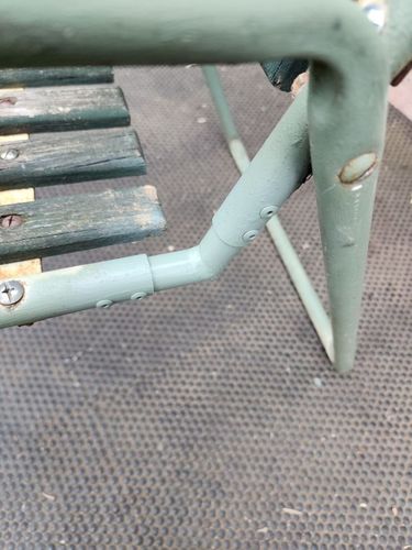

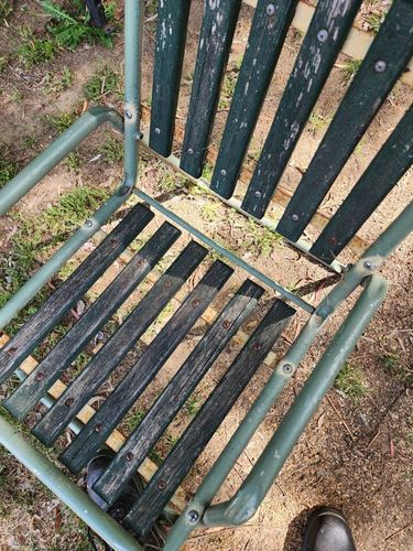

They're old - probably 66 years old. Aluminium frame.
I'm keeping them more to do with nostalgia that anything else.

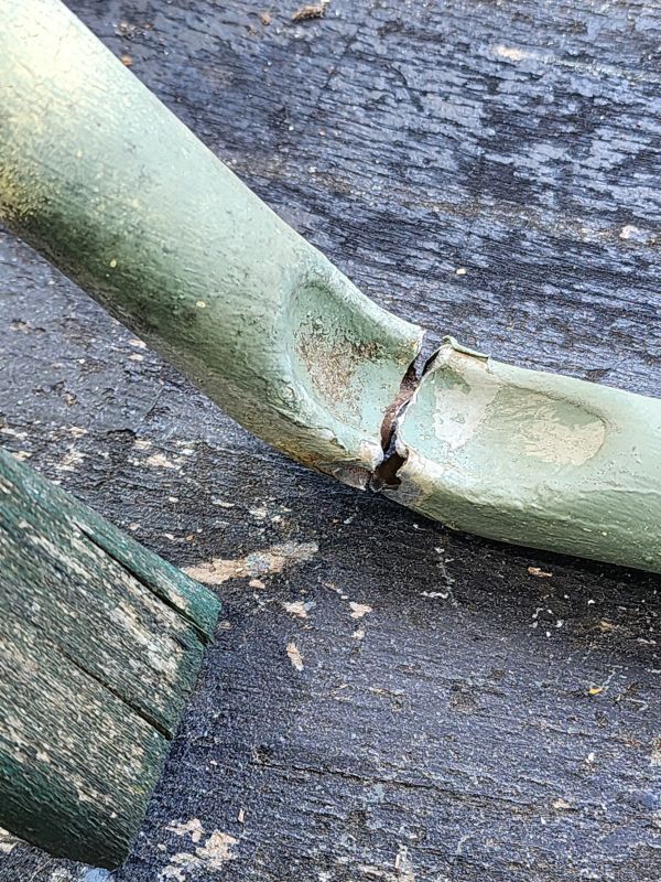

But today fatigue fractures have destroyed the frame, around the bent areas. Luckily I wasn't in it. 😁
This is how they looked.
Today...

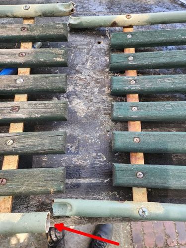

Start cutting the fractured ends off with a hacksaw...
Re: Repairing Outdoor chairs.
October

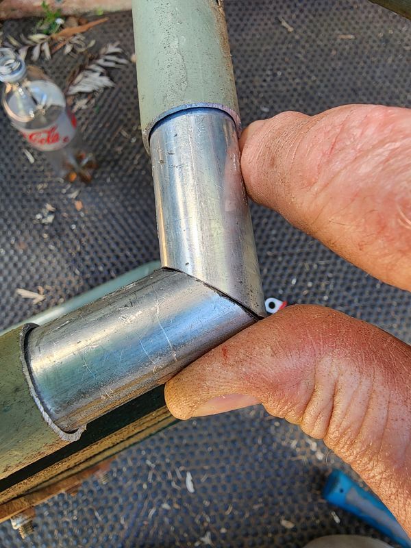

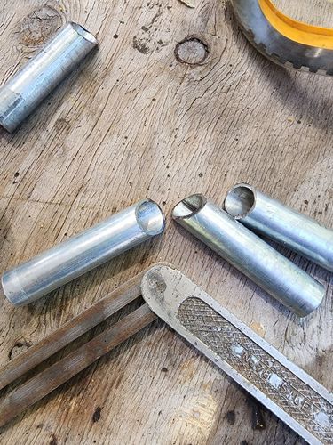

I found some steel pipe that fitted the internal diameter of the chair's tube.
Cut four lengths.
October

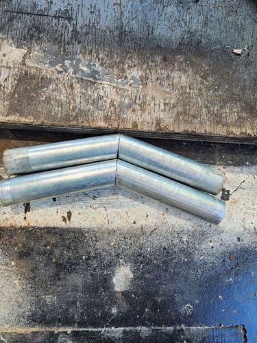

Hopelessly cut the wrong angles.
Second attempt was much better.
October
Fit into position...
October

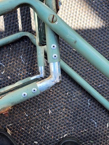

Welded and pop-riveted...
Painted...
Cheers! 😁
