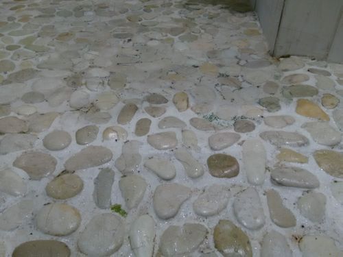

Are the liquidstone products self levelling? I'm wanting to resurface my bathroom floor which is currently pebbles/river stones with relatively large grouted spaces in between. I need a product that won't self level for the shower floor. Currently in the process of replacing grout and considering doing a liquidstone layer on top.

Welcome to the Bunnings Workshop community Susan (@SuseMck). It's great that you've joined us and many thanks for your question.
Are you planning on covering over the pebbles completely and want to use the Liquid Stone product for a finishing coat or do you want to use the Liquid Stone to fill in between the pebbles to raise the grouting height?
Mega Treat has advised that if the product is applied over the pebbles it will be difficult to remove the excess from them due to the acrylic binders included. Liquid Stone has a maximum coat thickness of 2mm per coat. There is a textured primer coat available from Mega Treat through special orders which is designed for filling in between pebbles and can be laid in thicker coats. The Liquid Sandstone can then be applied over the top as a finishing coat.
The Liquid Stone can be used in the shower recess as it is not self-levelling and is applied with a brush or trowel. You will need to apply a top coat of a clear acrylic sealer to protect the Liquid Sandstone.

Cheers Mitchell. Super helpful!
If we decide to go ahead, I'll go with the primer to boost the grout height and go from there. Thanks heaps.
