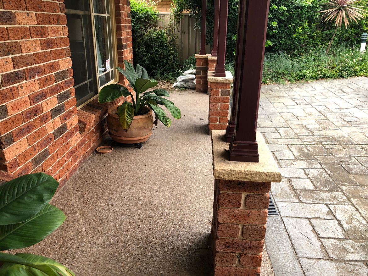

Front porch west
Last year I posted that I had had my pebblecrete pool completely re-surfaced. (See my first post for before and after).
Now I would like to get my front porch, which is also pebblecrete, resurfaced. I have had some quotes to have it skimmed with concrete but they seem very expensive.
The porch is undercover and buts up to a grey concrete drive. As I would like to paint my driveway dark grey again, I thought a matching concrete porch would be nice.
Is there a product I could use to re-finish the pebblecrete? I was thinking maybe something like a paving paint.
Does it need to be sealed first? I am really clueless when it comes to DIY but I'm willing to have a go at it.

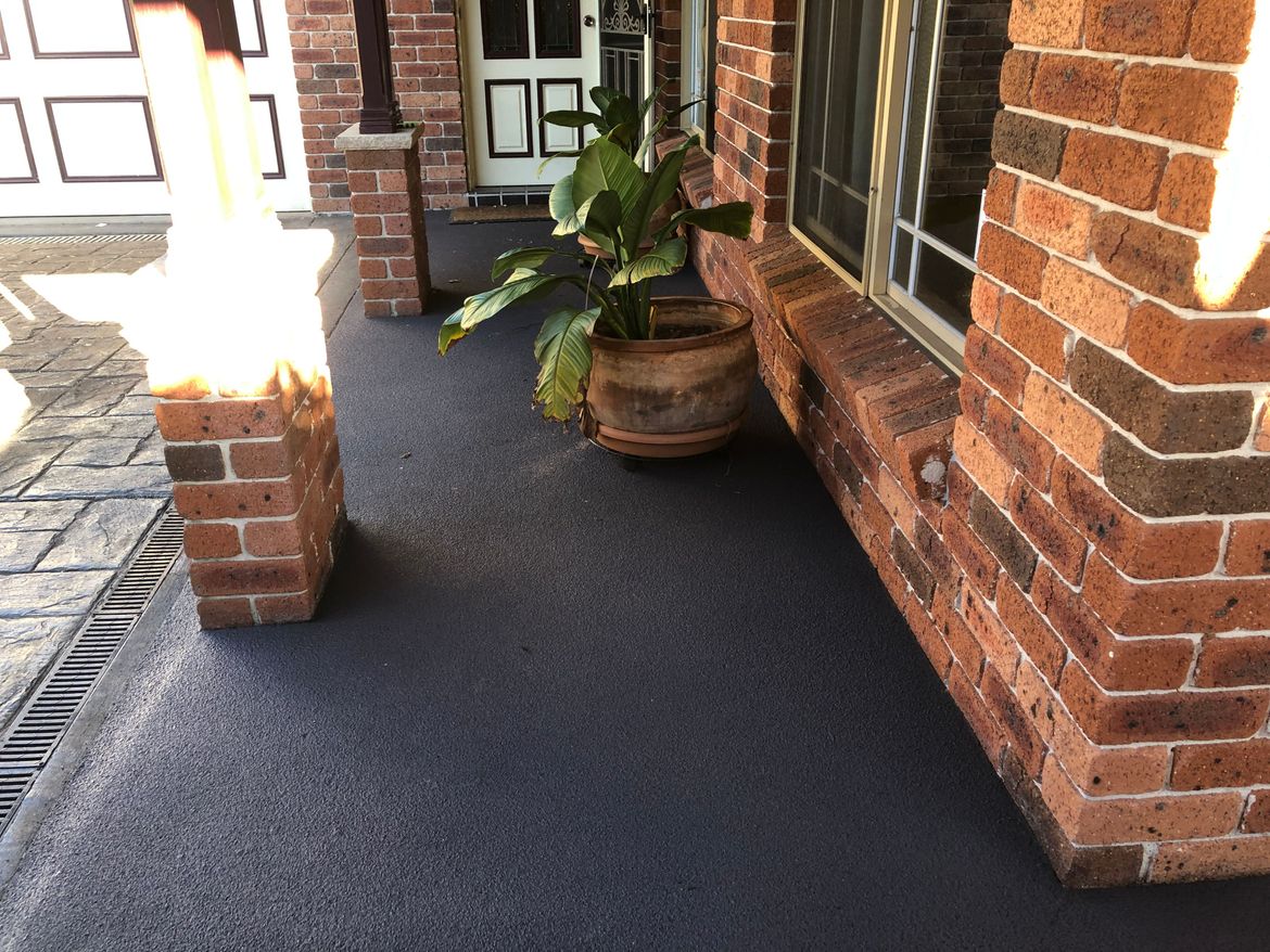

Thank you so much for the advice re-resurfacing my front porch.
It looks a million times better now it has been resurfaced. It is now a lovely slate grey colour. Trouble is...now my terracotta pots look daggy.
I would like to get my stamped-concrete drive re-surfaced in the near future... but all things considered I am very happy with the result.

Hi @JRRed,
What a great transformation! What product did you end up going with?
Many thanks for sharing the update with us.
