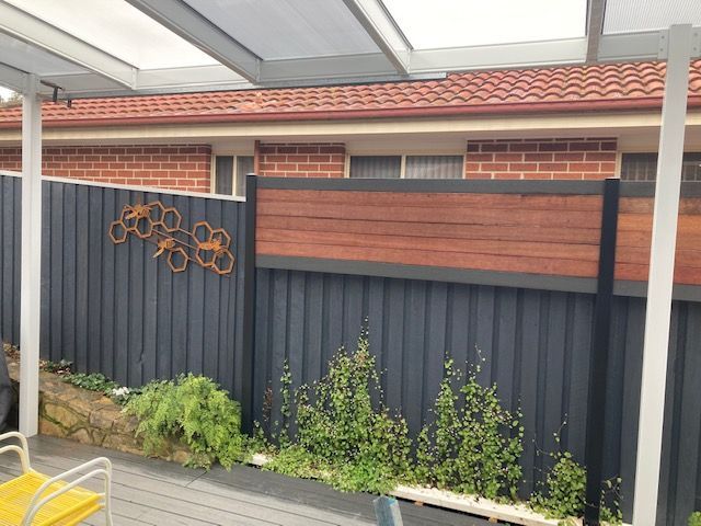

Wanted a bit of privacy after getting the new Pergola installed and was struggling with how to fill the 4 metre gaps between the steel posts. I saw that funksoulbro1 used steel studs and track in their Alfresco extension so I decided to also use steel as a framing solution. This is my first DIY project and absolutely loved it. I have no trade experience, just handy with a table saw, drop saw and drill. The result didn't turn out too bad.

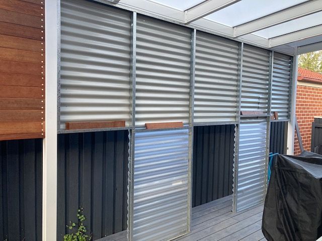

Corrugated Iron for weather protection on the external facing side of wall
The old privacy screen was a quick solution to give both sides of the fence some privacy when the Pergola first went up. It was a simple solution using Whites Screen Up posts and Merbau that would later be recycled in the final permanent screen. in the below pic you can see the first steel track in place on the horizontal rafter. As I was doing this by myself, I found the G clamp worked well as a second set of hands to hold things in place.
I decided to use white button head screws as they contrast better against the Merbau and tie in rather well with the White Pergola frame. The blue painted ply backing for the Screen Panel is also a good contrast. We were tossing up between Green, Yellow or Blue and as you can see Blue won in the end. Yet to oil the Merbau but the screens have been oiled.
The Corrugated Iron and Polycarbonate Roofing was from the old Pergola and recycled here to provide some weather protection on the external wall.

Welcome to the Bunnings Workshop community @Bankzee. It's sensational to have you join us, and many thanks for sharing your wonderful project.
What a corker of a privacy screen! I love the effort you've put into creating a visually interesting screen, not just a functional one. I'm sure @funksoulbro1 will be pleased to hear that their project gave you some good ideas. The steel frame looks like it worked exceptionally well. Would you say it was more challenging to use than timber? I really like the idea of knowing all the framing pieces are perfectly straight and not having to deal with the natural imperfections of timber.
Many thanks for sharing, as I trust your project will inspire our members looking for screening solutions.
Re: Privacy screen for pergola
That privacy screen is awesome @Bankzee, the colour you've used behind your sceen isn't something I've seen before, but I like it. The contrast between the screws and Merbau is a great touch as well
Well done
