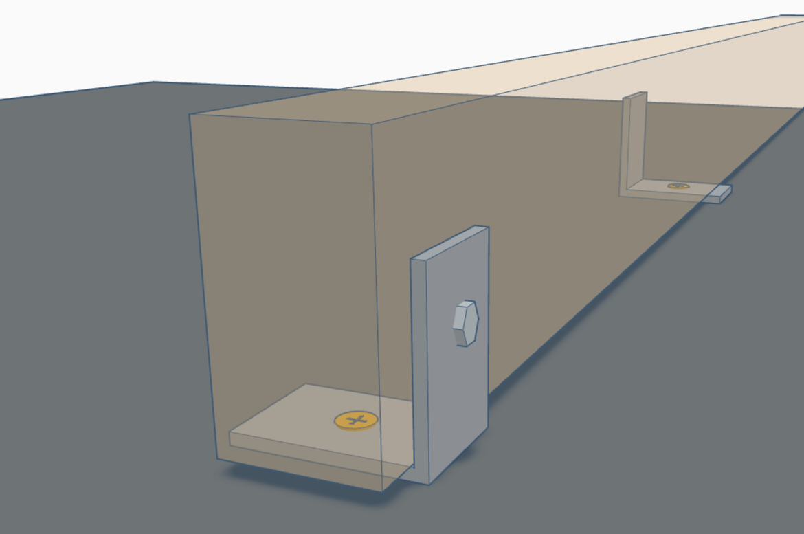

To assist in inhibiting decay on the joists you could coat the bottom of them with a bitumen-based paint. This coating will stop them from sitting directly in any water. I'd recommend that you use that last 7mm to mount your brackets under the joists instead of next to them. This will raise the timber slightly off the ground. You'll need to use brackets and countersunk Dynabolts to get them to fit within the 7mm gap.
