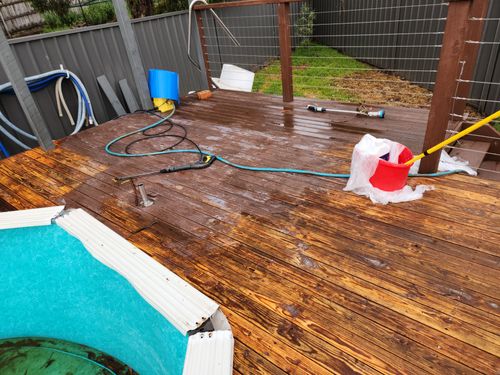

Hello @Jeanagh
Thank you for sharing those images of your deck. Looking at the photo you posted, I suggest sanding the surface clean. Because you've applied the stain this will need to be sanded off and the surface prepared again. Please make sure to give the first coat enough time to cure.

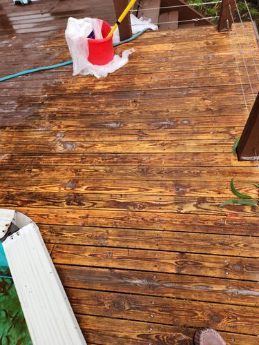

Re: Pressure clean sand and stain outdoor deck
So, I'm about 1/3 the way through. Between the rain and my medical limitations it's slow going. Hopefully finish stripping it today ready for sanding when it dries out. Being Melbourne who knows when that will be.
just this bit to go
Hello @Jeanagh
Thank you very much for posting your work in progress. That paint stripping is looking excellent and the deck's surface looks very clean. If the rain ever stops and you get a forecast of good weather for a week, that would be the ideal time to repaint or stain your deck. Please remember that the deck has to be totally dry before you apply anything to it.
