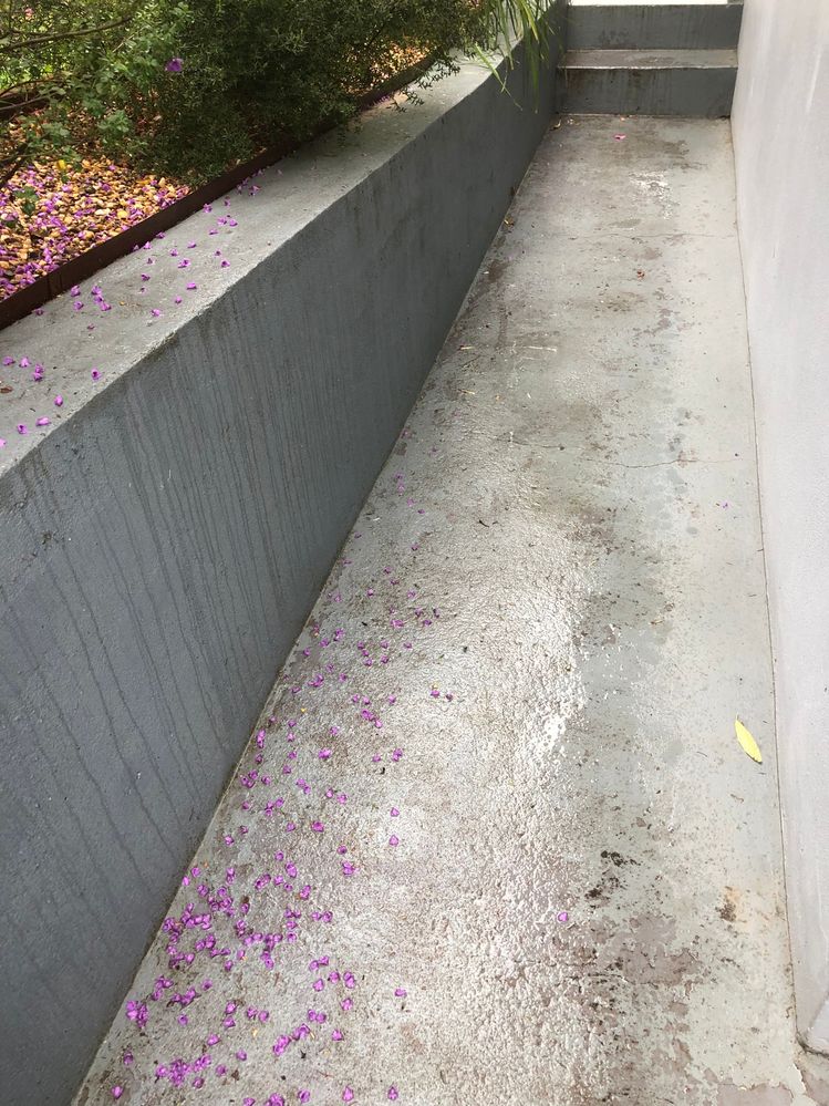

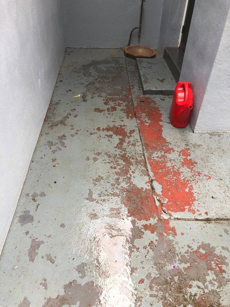

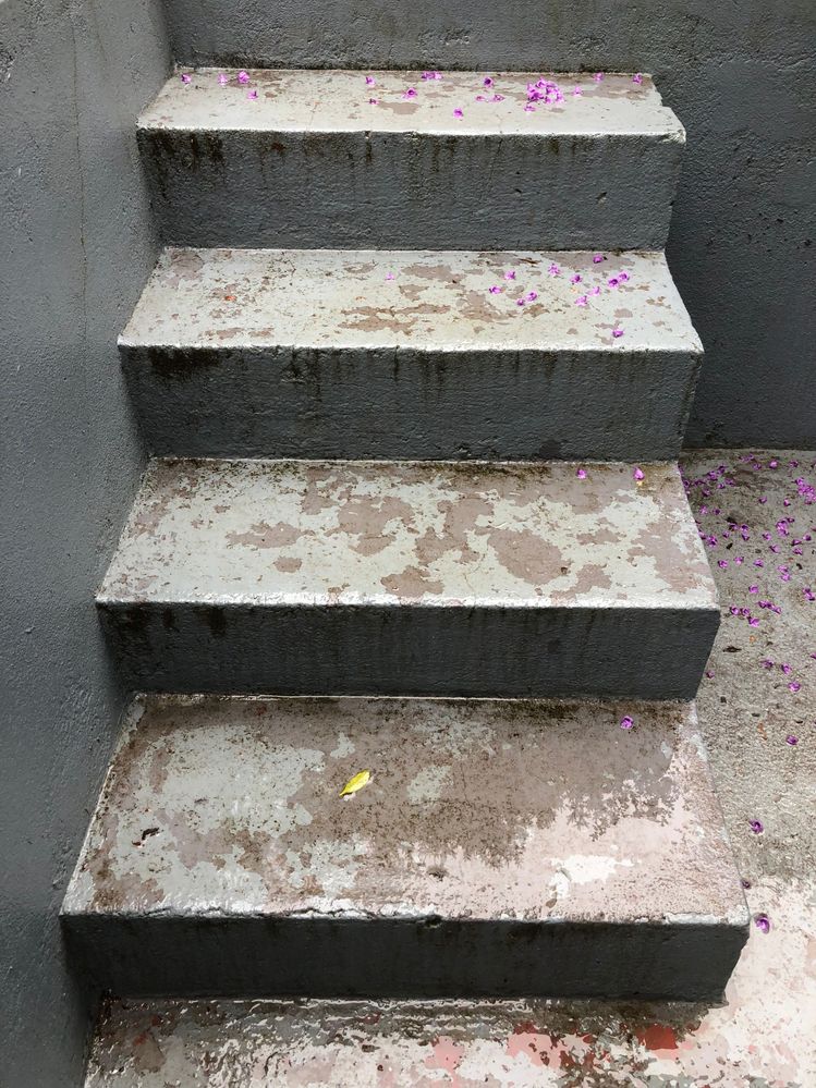

We are wanting to paint the concrete path/steps at the back of our house.
As you can see the area gets quite wet, and has a lot of peeling paint on the surface. Can anyone help me out with
1. How to get the old paint off
2. How to prepare the concrete for painting, what products to use
3. What products/paint to use that is nonslip, water/mold resistant and gives a thicker coverage to cover up the cracks/chips in the concrete
thanks in advance

Hi @selvins,
Thank you for your question about repainting previously painted concrete.
Unfortunately, due to the condition of the current paint, you will likely need to have the concrete ground back to bare before it can be recoated. Due to the risks involved in concrete grinding, I would suggest engaging a company that specialises in concrete grinding for their assistance.
When the paint has been ground off, you should use Gripset Betta Concrete Crack Filler to fill any cracks in the concrete.
Once the cracks have been filled, you can use the Dulux Concrete and Paving Range, which is a 3-stage system comprising an Etch & Clean, Concrete Primer and paint.
You can use Dulux 4L Concrete & Paving Super Grip Medium Tint which is a high-quality concrete paint designed with slip resistance in mind.
Have a look through How To Paint Concrete Floors for some further guidance.
