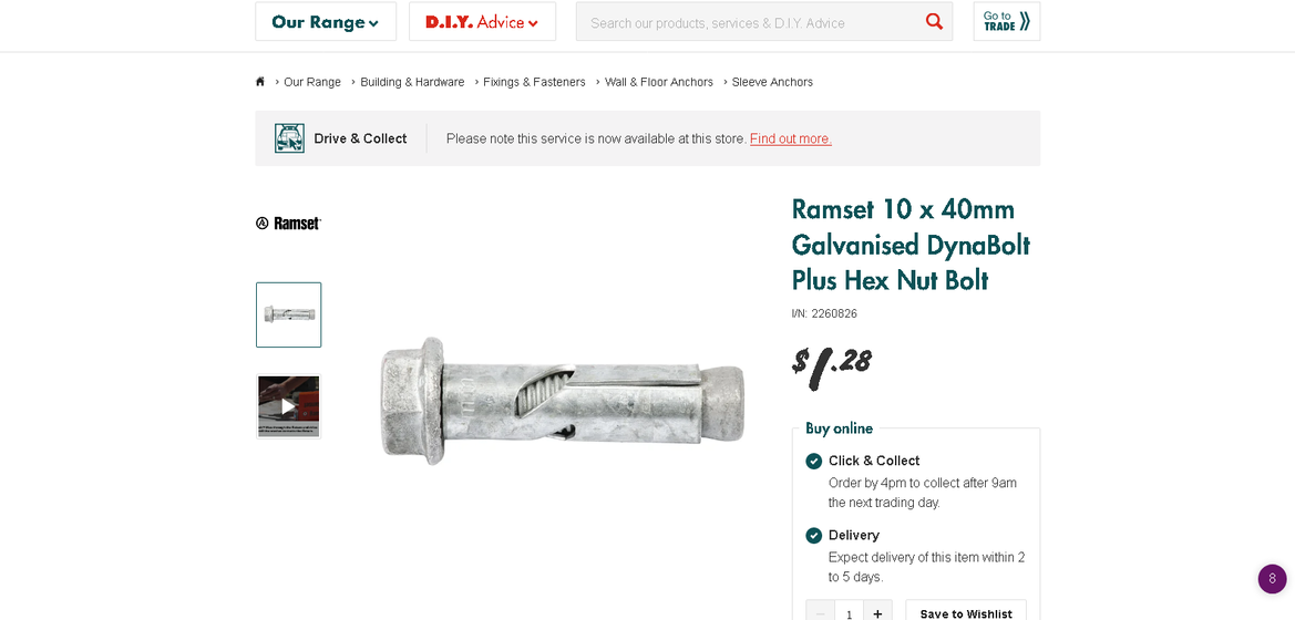

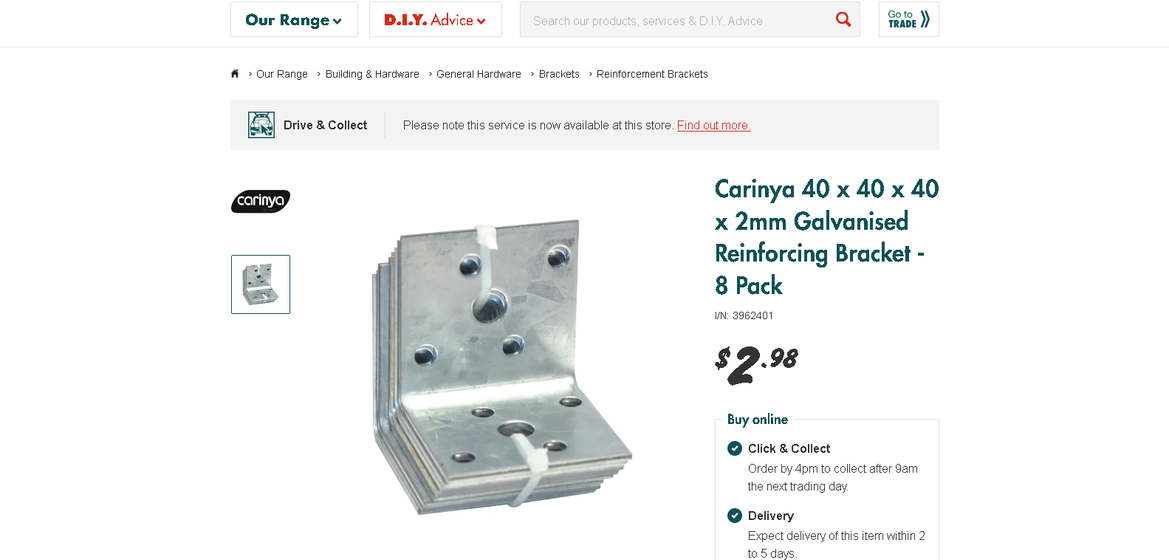

Hello @MikeyT and welcome to workshop. Depending on the size of rails of your fence, using a standard galvanized bracket on each end should be sufficient enough to hold your picket fence in place. I suggest galvanized so that it will be ok for outdoor use and will withstand the weather. Mounting on to the bricks you can use either galvanized dynabolts or a treated screw and a brick wall insert. I've attached some sample photos below.
