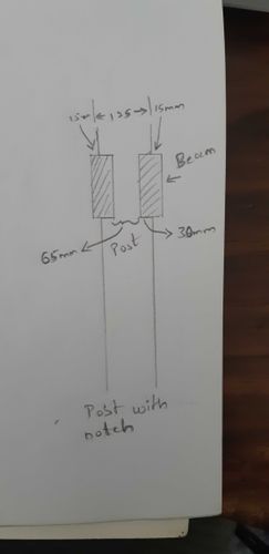

4. Now looks like I have hit another hurdle. We have Cypress posts of 125 X 125 and 2.7m in length. Beam of TP 240mmX45mm (2.2m length post to post). I am planning to use 3 Bolts M10 X 150mm or +220mm Cup bolts (based on notch it or not) to secure beams to post.
5. We have Rafters 140X45 and Louvers 90 X 45 to be sitting on beams.
What are you recommendations on securing / mounting beams to the posts? Is notching good or it weakens the posts?

Side view.
When you look straight at the post
Topview before notching

Yeah! thank you @MitchellMc and @ProjectPete for you inputs. I think it makes a lot of sense to make notch and then mount the beams.
Is there are rule of thumb that once the beams are mounted it should sit flush? or it can have an over hang about 10 to 15 mm?
Example
1. Beams are 45mm
2. Posts are 125 mm
3. I am planning to have 2 beams (like the way I have showed in side view image attached to my first post).
4. Now If I notch 45 mm on with side of the post then I will eat up 90mm and I post will have only 35mm left at the place of notching.
5. Would 35mm on post be enough or be strong enough to hold 3 M10s, wind etc. Overall strength.
or
6. From point number 4, I just notch it 30mm on each side and I will eat up 60mm only against 90mm (in step5). I will still have 15mm overhanging when I mount the beam but I think its weight will anyways be already transferred to the post as it will have more than 50% of its body mounted onto post.
Let me know your thoughts. I am a vaguely remember reading strength of materials during my engineering days (13 years ago ) and later moved into software side of things.
So please forgive for the terminologies used here if they are unclear. I will try to draw it if needed.
Thank you!
Re: Pergola Post - Notch it or do not notch it?
The beam does not need to sit flush with you post, in fact, you could have only one-quarter of the beam notched in as long as it is bolted securely. Just remember you don't need to notch in at all. I also do not think you are eating up too much of the post with the mounting. You might like to notch in slightly less to leave more of the post.
