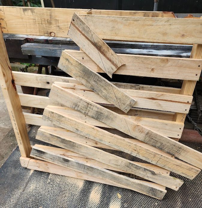

2 pallets with HT certification
Disassembled and nails removed.

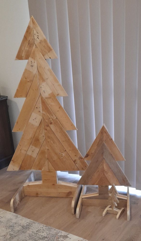

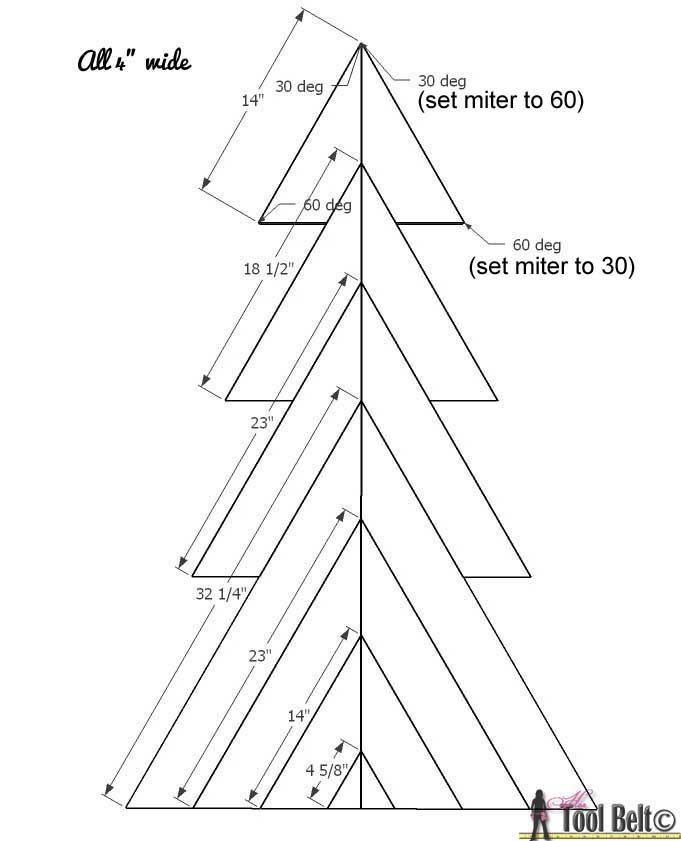

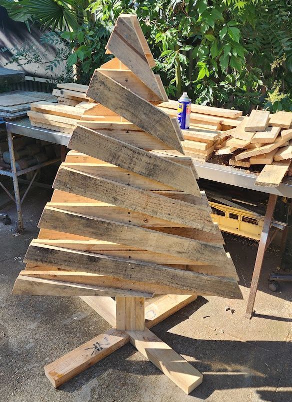

The Angles were calculated from this pattern and templates were made. So that simplified the cutting of the boards which were cut together so one could be flipped.
These cut boards were, placed on a backing plank and screwed, glued and nailed. This plank was allowed to protrude at the end by about 6-8 inches so that the feet could be attached.
The feet are of a H design and the tree is fixed permanently. In th4e next prototype we would like to design so that it is removable. for easier storage. The feet were designed by Tony so I can't really describe how they were done.
The were finally sanded to removed splinters. They can be painted or varnished. Also, will allow for signage to be stenciled onto the branches with a Christmas theme.

The pattern was a free pattern thanks to Tool Belton You Tube

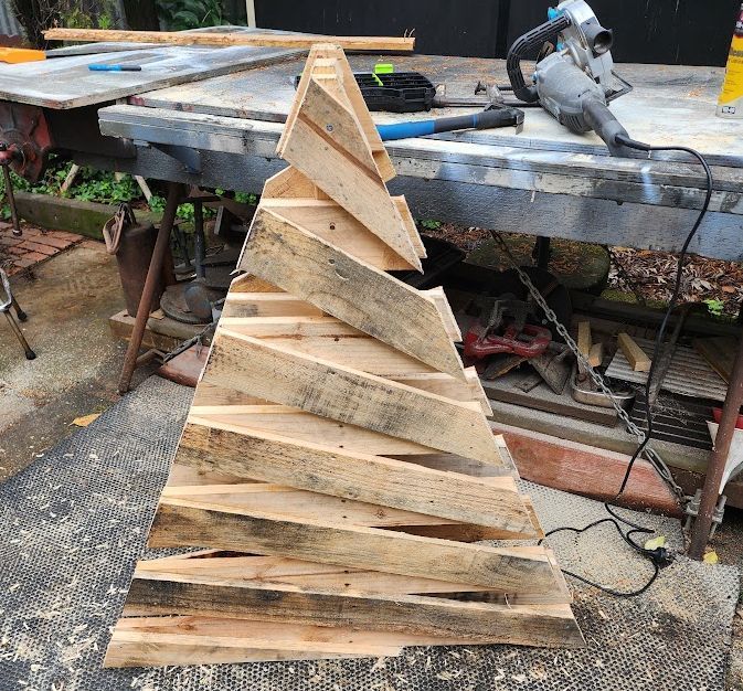

Getting there....

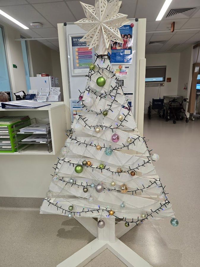

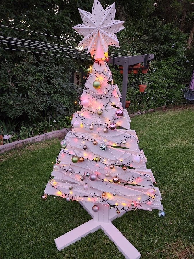

Now positioned at her place of work...

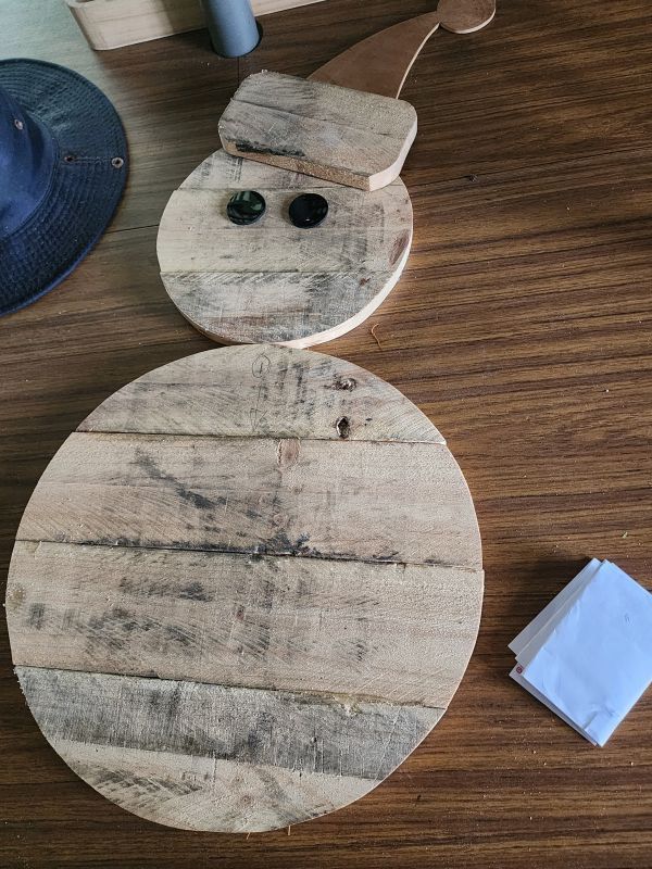

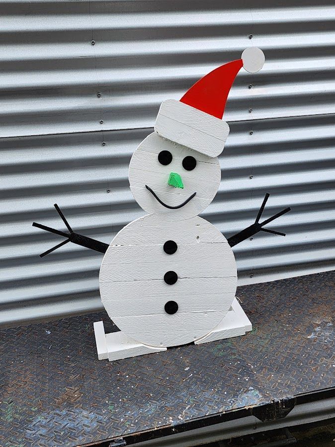

Frosty now has arms...
