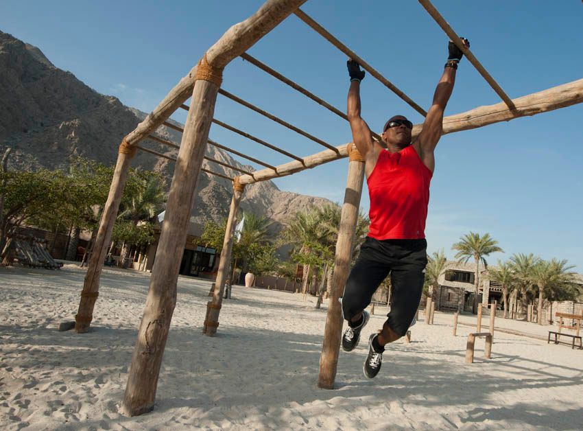

Re: My adult jungle gym
I don't really understand what you're proposing. Could you maybe give us a sketch or something? Jungle gyms are typically bars for swinging - why the platform on top?
