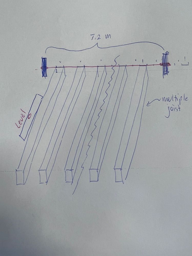

@MitchellMc For the joist to be installed over concrete (that has some fall) how do you ensure that the joists are level to each other without using a ledger board?
I'm thinking of running a string line that's level and using that as a guide to align the top of the joists.  Is that a good strategy or is there a better way?
The length is 7.2m and i'll be using around 19 joists accross.
Re: How to build a low-level deck
Hi @archerwinmakes,
A level string line is likely your best option over 7.2m. For smaller decks, you can place a stick of timber across the joists and use a level on top of it. You should find one of these Craftright Level Line Surface Sets useful.

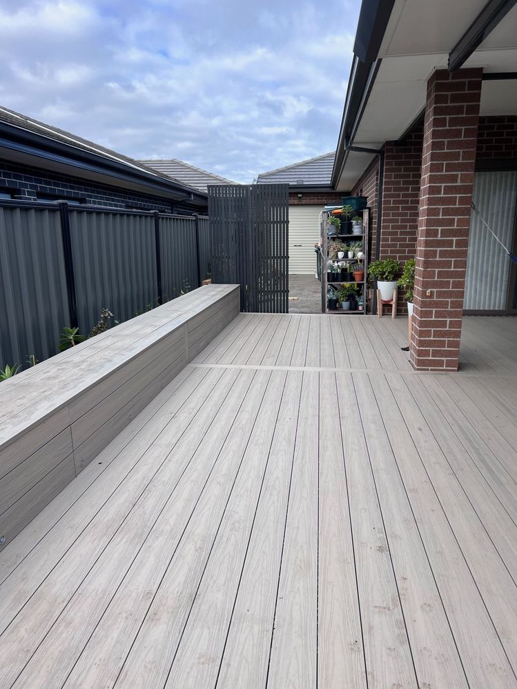

I forgot to update this post with the finished deck.
My father & I completed the decking in about 3 weekends.

Thank you so much for the photo updates. The deck looks marvellous and the colour you've chosen is just gorgeous, can you please tell us the name of the colour you chose for the decking panel? What did you use for posts in the soil section of your deck? How long did the entire project take?
Again, thank you for sharing such a wonderful decking project.
