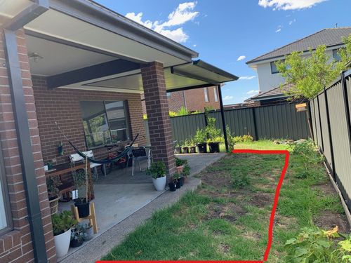

Great community here. I've been reading a lot about building a low level deck. But still have a few specific questions just to make sure before I buy the materials.
I plan to build a low level decking on top of my concrete floor and will span around 1.8m across the grassy part to the right of the photo.
I plan to use 70x35mm for the joist as it has enough height to just level with the floor of the house after decking is installed.

Could we please know the height from the concrete slab to the house's floor and the overall dimensions for the deck? I can then recommend timber sizes for you to use and will provide a plan of how you need to set out your decks bearers and joists.

The concrete slab is 145mm lower than the house floor. The soil is around 80mm lower than the top of the concrete slab.
The total area is 7.34 m x 5.20 m. Area in concrete is 7.34 m x 3.20 m and area in soil is 7.34 x 2.0 m.

I'd recommend using Treated Pine Outdoor Timber Framing 90 x 45mm for the joists. The 90mm joist plus 19mm decking will then allow 36mm for airflow and drainage. You'll need two supports over the soil area, one being the midpoint. It would be a great idea to lower that soil and lay some drainage matting and gravel over the area.
I've included a basic diagram below.
