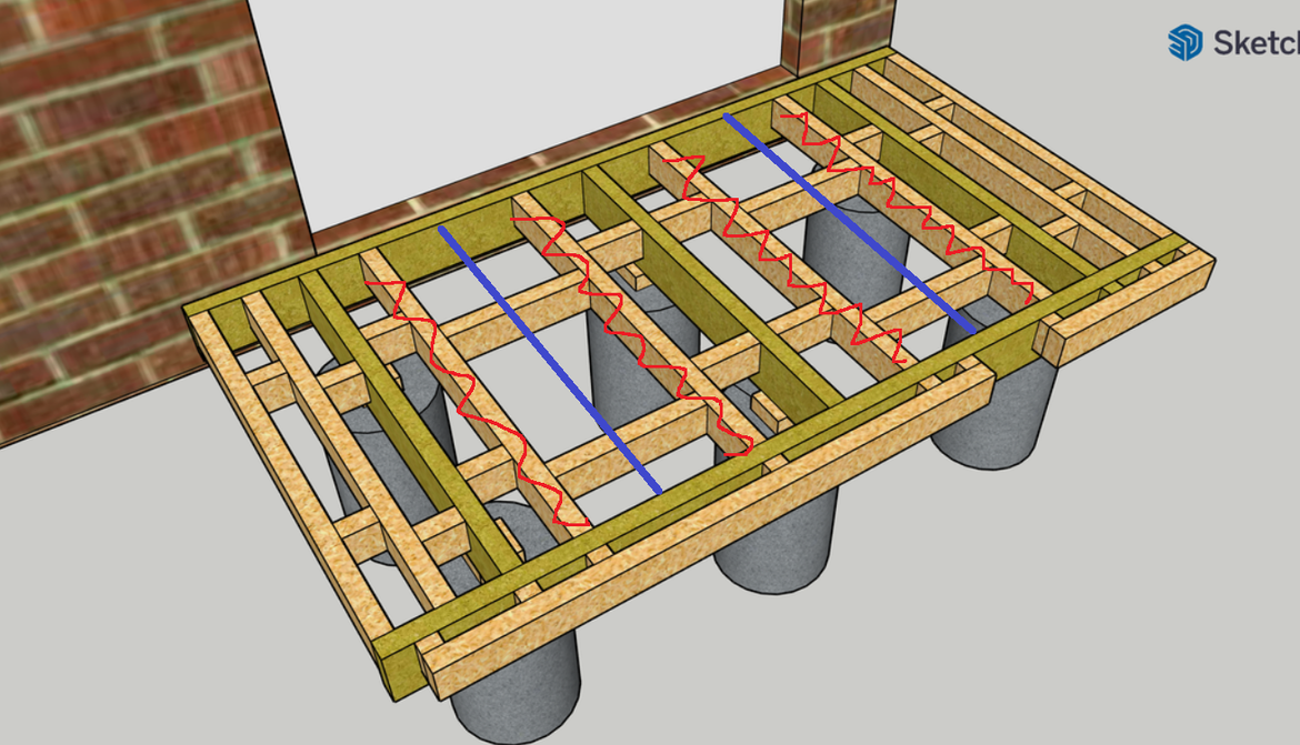

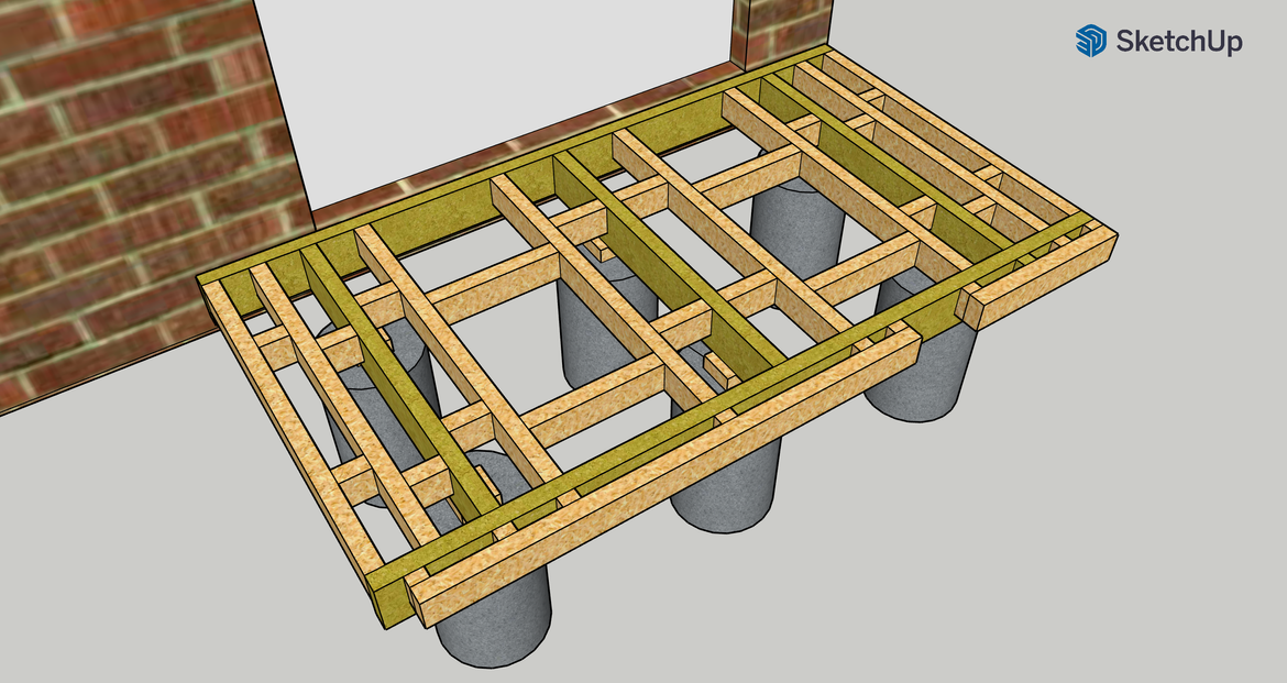

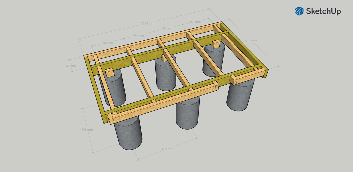

I spend a little time redesigning and perhaps a little overkill, if anything could be removed or modified let me know
design changed to 140x45 bearers and back to 6 footings @ 745 on centre.

Re: How to build a low-level deck
That's much better @TimGeo. I think you could cut down the number of joists you're using there as some don't seem to have much use. I've added a rough edit of your design of the joists including the ones I'd remove and how you should respace them. I've also created a rendering of how the deck frame could be built a little more efficiently. See how by laying your bearers in this direction the smaller calibre joists don't need to span as far?
There's nothing wrong with your design, but it could be neatened up a bit. I'd remove a couple of those joists and have an
evenly spaced one between the bearers instead. You typically want to space the joists/decking fixing points 450mm apart. You'll be nailing the decking off to the top of the bearer as well, and currently, you have the joists spaced like you won't be nailing off to them.
Structurally wise you're pretty much right to go, I'd just like to see those 90 x 45 mm spans less than 1000mm.
that's heaps better, and much less material wasted, thank you! I'll make the neccesary changes and go with that. I'll be posting photos of the project as i progress, appreciate you taking some time to reply!
with your design would the cantilever design still be fine to use?
So just as a final point and to check tolerances:
Concrete supports 800mm o/c left to right, 768mm o/c front to back, depth:500mm
100x100 posts set in concrete, notched out 45mm for bearer support
joists spaced as evenly as possible as seen in dimensions.

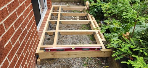

After some back and fourth with the guys on the forum and plenty of designing and measuring, I'm posting an update on my backyard landdscaping project, first up is the laundry decking, since it's a small area and the cost is more manageable, I thought it would be a great place to start and give me more motivation to keep going and build on the momentum.

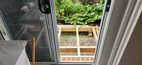

Anyway the area in question is the laundry exit, it's about a 200mm+ drop from the bricks to the ground level, which is not ideal and it's a little akward stepping out the sliding door, I find myself stepping out wide from the tiles to the ground, to avoid stepping on the sliding door rails, another problem is if I'm carring the laundry out I have to step sideways which is also an issue.
I really want to have a nice continuous flow out of the door and have some firmer footing as I step outside, the ground level will be corrected and slightly higher than current with compacting some base and paving installed in the near future. And possibly some more decking around the other side to continue the design flow, which i will be posting about when that time comes.
The Laundry:

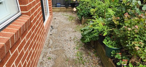

Side view of area:
View from directly opposite:

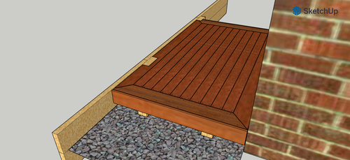

The plan, all designed in Sketchup:

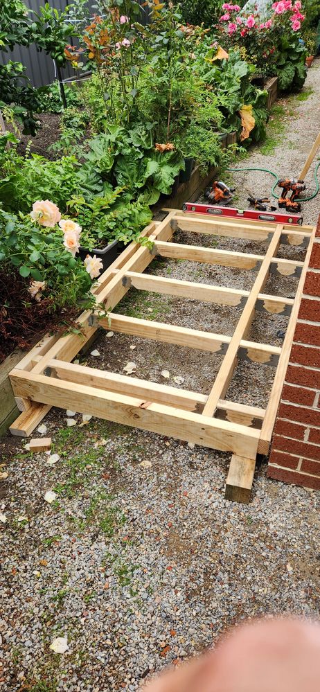

I took the opportunity to build the Deck structure in the garage being a nice flat surace to work on and once completed I brought it out and dick a test fit to check clearances and see if there was any need to adjust, Lucky I did as I had made a measurement error but i'm thankful I had an offcut to fix the issue. So far so good! I screwed in a couple of scrap blocks of timber on the garden bed under the bearers to use as a reference and to make sure the deck is level.
I decided that the posts of the garden bed need a 5-10mm trim that way I can completely cover them with merbau rather than having to trim the merbau around the posts for a clean look, I've also decided the remove the step in the gaden bed so it's flush with the deck, which is easy enough as I need no additional materials to do that!
For now that's all I have, I'm waiting on some more free time to dig and set the posts in concrete and then I can complete the rest of the job.
I'll post my next update soon but thanks for tuning in!
