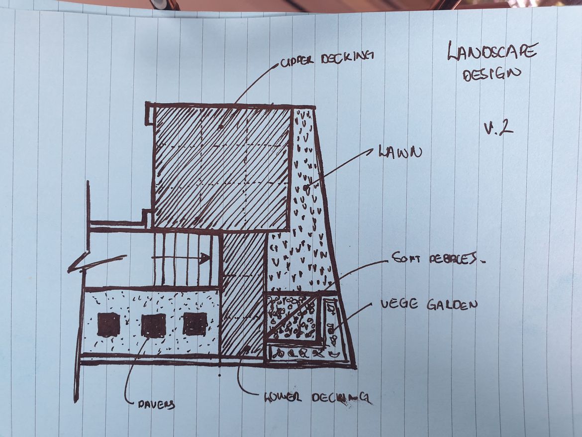

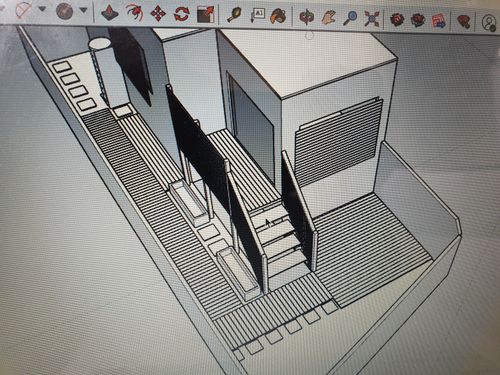

The backyard hasn't had a lot of TLC since we moved in and I've finally procured all my timber and tools and finalised the design as well. Cheers to the inspo from others in the workshop. I'm also using the Good times modular decking frame etc but cutting my own boards.
Original design
Final design

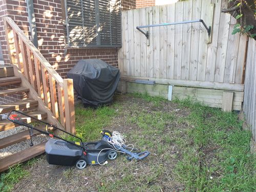

This is the space im working with.

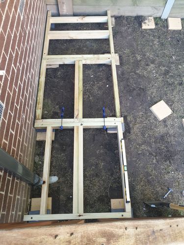

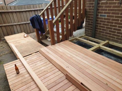

Frames went together relatively well. Had to shorten some but I worked this into a design feature.

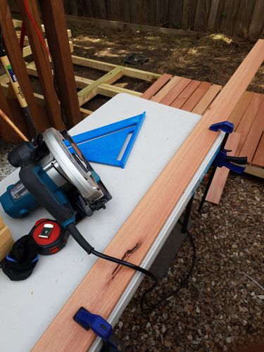

First time getting hands on with my brand new circular saw. Quickly got the hang of it.

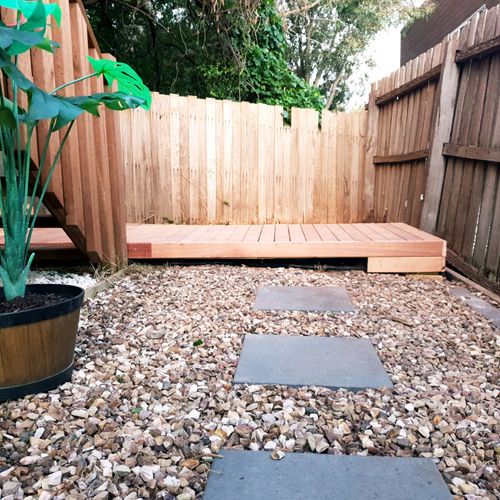

Getting towards the end.
Unfortunately used the wrong screws (frame screws not deck screws) for the walkway. Thanks to the bunnings screw for helping out before I started the main deck. Still need to figure how I'll deal with the walkway screw issue.

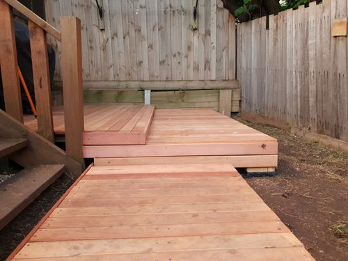

Easter Monday progress
