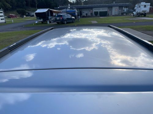

Hi all. I know there are other places to ask but wanted to get some advice here first. I drive a 2006 Subaru forester. I know very little about awnings, car tents and car modifications in general. I’ve attached photos of the roof of my car and wanted to know can I attach an awning as it is? Or do I need a roof rack or something first to attach it onto. If anyone could point me in the right direction in terms of businesses to visit to get this sorted I’d also appreciate it. Thanks!

That would very much depend on the awning you intend to purchase and how it is designed to attach to the vehicle. If it's an awning specifically designed for the Forester, then they might have adapted the brackets to fix onto the roof guides. However, if it's a generic awning, then you would need to adapt your vehicle to suit.
I would suggest that you search awnings to suit Subaru Forester. If you don't have any luck, take a look at awnings that suit your needs and the way they attach. If you can provide us with details on how the awning is designed to attach, I trust our clever members will be able to come up with some ideas on how you could attach it to a roof rack.
