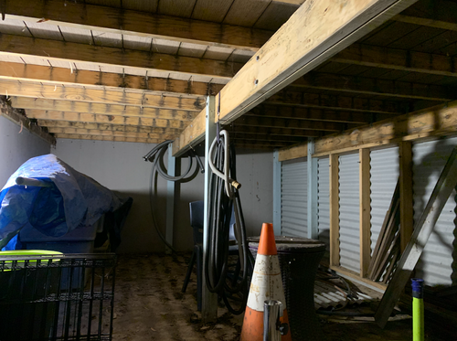

We have a 5.0L X 3.0W X 1.7H deck which has an enclosed area underneath - except for the rain that comes from above!
I want to waterproof underneath the deck so I can have an additional storage space.
My thinking is to get 17mm polycarbonate sheeting and use 42 X 19mm H3 DAR Pine to help create a 1:10 fall across the length.
The deck has 13 joists. I’ll screw the 19mm pine underneath 3 of these joists, using spacers to help create a 60mm fall across the whole length. Photo below.
I’ll then attach the polysheets to the joists that have the 19mm pine screwed in. Then a gutter at the end to catch the water.
Questions
- Is the 42 x 19mm H3 pine suitable to be used as described? It is quite cheaper than other H3 pine and want to ensure it’ll be okay to be damp for the most part of winter. The deck won’t dry much during winter.
- Is a fall of 10mm every 1m sufficient? I’ve got about 60mm across 5m.
- Any other recommendations?
cheers

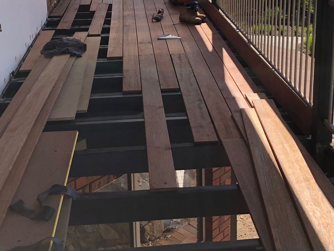

If the deck is screwed down, then the easiest solution is to remove them and get made up colourbond trays that will sit between the joists. They will need to be angled to allow for drainage. Then run a gutter along the length and have it connected to your storm water by a plumber.
I haver done the exact same project myself. as per the attached photos.
all the best.

Hi @Nailbag
The Colorbond Trays you use, where do you purchase these from and are they custom made to size?
Our deck is 3000mm wide so I could flush the trays against the wall (left side of photo below), run them between each joist to the opposite side on an angle to a gutter. There is a stormwater pipe near which a plumber could tap into for us.
I notice the joists in your photo have black tape (?) around them. I assume this is to avoid moisture from accumulating in the joists?
...and my last question...how did you fix the trays to the deck? I can't see any screws!
Thanks heaps!
Re: How to waterproof under deck?
Hello @Bubbles8712
Let me tag @Nailbag to make them aware of your questions. The tape you are referring to is called CAgroup 50mm x 20m Bearer Protector G-Tape. It comes in a larger size of 100mm if you wish it to overlap the sides.
