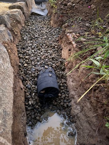

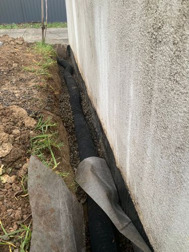

8mm gravel would be perfect, Mahon (@approachmhn).
