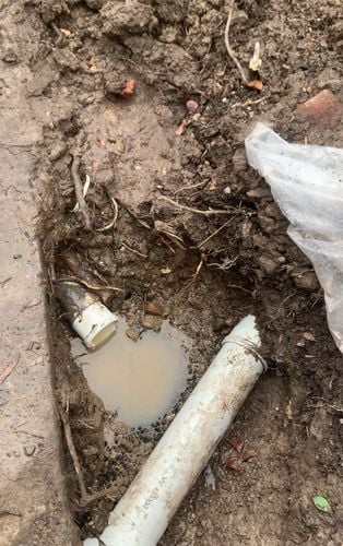

I have an old pipe that is not connected anywhere which is next to storm water pipe that runs towards road.
The issue is when it rains, water comes out of this unconnected pipe and ground gets very damp in that area.
recently I dug that area and got plumber. Plumber put a cap to the pipe and asked me to monitor if water still gets out of  pipe when it rains.
i see it still slowly fills up the area meaning water is also coming around that pipe.
This unconnected pipe is under driveway which is concrete and solid. No gravel around pipe. So, I suspect the damage to pipe is very near to the opening.
my questions is
1) how do I check the damage
 to pipe?
2) if pipe is not leaking or if I can fix that leakage, how do I connect unconnected pipe to storm water pipe so water would not flow back. Unconnected pipe is around 1-2 inch below storm water pipe.
Appreciate your help.

Plumber actually backfilled with gravel. Not because he wanted to but that was the easiest to do because clay had hardened and was not easy to backfill.
There was about 20 cm of gravel mixed sand on top and then clay under.
While digging I had separated them.
When plumber was fixing last Wednesday, I was away for 10 mins towards the end. By that time he backfilled gravel and put some soil on top. Asked me to backfill clay later once backfill settles.
Also, he just closed the deck boards without backfilling under.
A light rain yesterday and I could see water flowing because one of the deck boards was not screwed.
          Called him to ask. He said he will make a pit to soak water and was not ready to accept the issue.
Most of these people will have 5 star reviews. Not sure how they get it.
I had to dig again this morning and backfilled with clay first. And compacted the soil as @JacobZ suggested.
Hope this will fix.
It’s too late for me to do agipipe. Sorry
I was waiting for rain to check and update you guys in this forum, but had to go through this.
will wait for another rain, and see how it goes.
