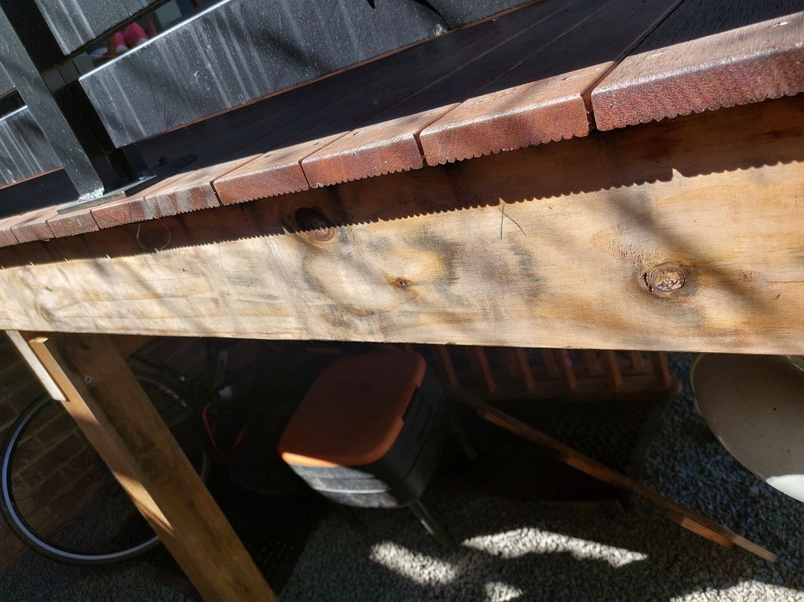

I have a deck that is Merbau and has been treated with Cabot's Aquadeck Merbau. I now want to stain the supports, that I believe are treated pine, to be a similar colour. What is the best way to achieve this?

I propose testing the Cabot's 250ml Merbau Water Based Deck And Exterior Timber Stain on the pine surface. I suggest testing it on a portion of the deck that's not directly visible from the front. Please make sure to follow the application instructions and to wait at least two hours before applying the second coat. Have a good look at the finish and if you are satisfied with the stain, you can then get the larger can and commit the rest of the supports.

Let me tag @Goodo9980 to make them aware of your question. It would be interesting to find out if the stain on the pine was satisfactory. However, I encourage you to test a small sample on your own deck so that you'll have firsthand information if the finish is to your liking.
Hi @K8ie,
So far I've only got to the point of testing some sample areas. It looks promising.
I'll hopefully get the rest done this weekend so can let you know after that
