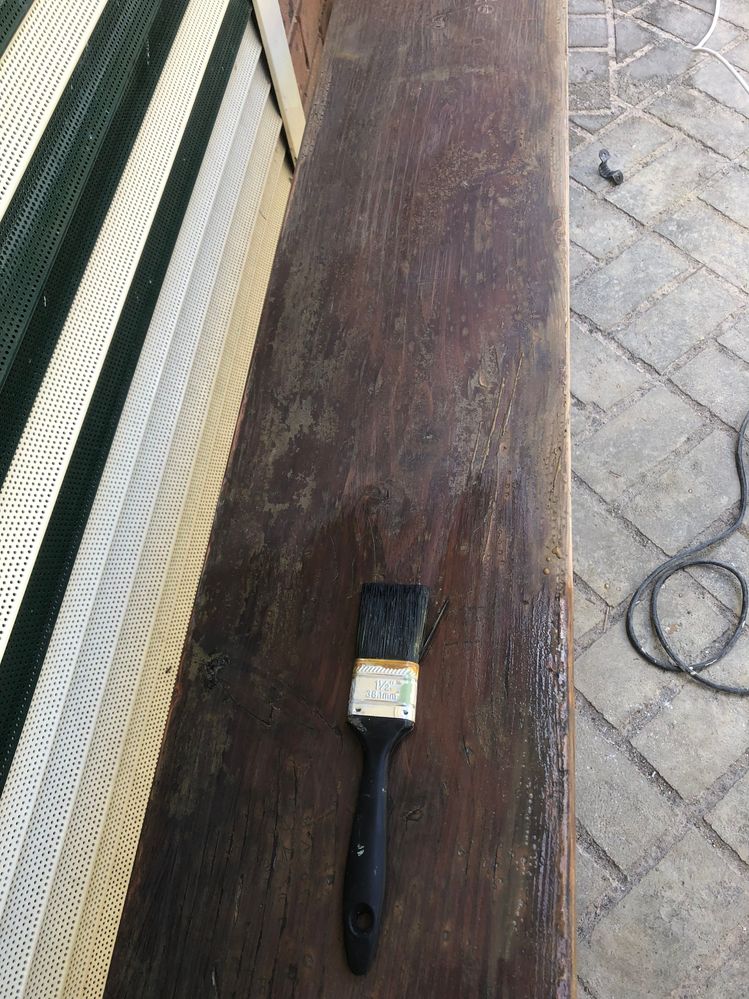

@TedBear  Just to follow  through  i re sikkened the out door seating plank that was done about 15 years ago first time,  All went well I did  orbital quick sand the plank 10 mins worth,  just to remove damaged marks on the wood but I didnt try remove in grained old sikkens product.
Well I also had the original sikkens can i used  for the first 2  coats and it  was sealed properly and when opened looked as normal and  ready to go after a quick shake/mix just in case.
I slapped a quick coat on the timber on all 6 sides I took a  couple pics of the half  painted section  and the final coat as a  comparision.
Sikkens not gone off in tin after many years  yeah.
Half timber painted for comparision of old sikkens and fresh sikkens over coat,
Half just painted compareHalf just painted compare
Sikkens  dried  1 hour later and when rubbed firmly  with white cloth there was  no  marks on cloth and it dries  with a semi gloss shine.  So I have confirmed to my self sikken s is easy to brush on and years later it is  easy to re apply a new fresh coat with optional sanding and  took minutes, good to go another 15 years.   I would  give the job a  final wet and dry sanding just to take off mirco spurs you get when you paint a quick light sand  480 grade wet and dry  My  sikkens was tinted so the more i apply the darker the timber stain as a side note.
1 hour later sikkens dry1 hour later sikkens dry
