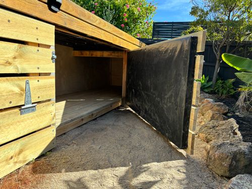

I would consider incorporating a gate and then once finished you can line the back with builders plastic to reduce weather getting in if you want to use the area for storage. This is what I had done for a mates pool deck.
