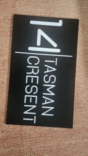

I have a customised House Number sign built on ACM sheet - 500x300 mm size. I want to use the standoffs without drilling - can I use liquid nails? If not, what are my options?

Thanks for sharing your question about installing your house number with standoffs. Would it be possible for you to please post a photo of your house number and the wall you're planning to mount it onto? This will give our members a better idea of what the house number looks like and the material of the wall. One possible way to mount it is by using timber ends with a routered channel. In this manner no glue will be applied to the ACM sheet and the only thing screwed on to your wall are the timber ends.

A couple of photos would be good and also what edging thickness you may be after?

If the standoffs have a sufficient surface area, say 10mm, then you could probably use Sika 290ml Sikaflex®-118 Extreme Grab Construction Adhesive to glue them onto the render and then to the sheet. However, drilling and using fittings would be a far more substantial connection.
Ensure you tape the standoffs and sheet in position until the adhesive has entirely dried.

I have installed the same type of offset panel and can highly recommend @MitchellMc suggestions for the Sikaflex adhesive. You will just need to use something like a cloth tape to strap it in position for 24hrs to allow it to fully cure.
