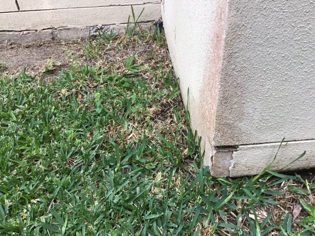

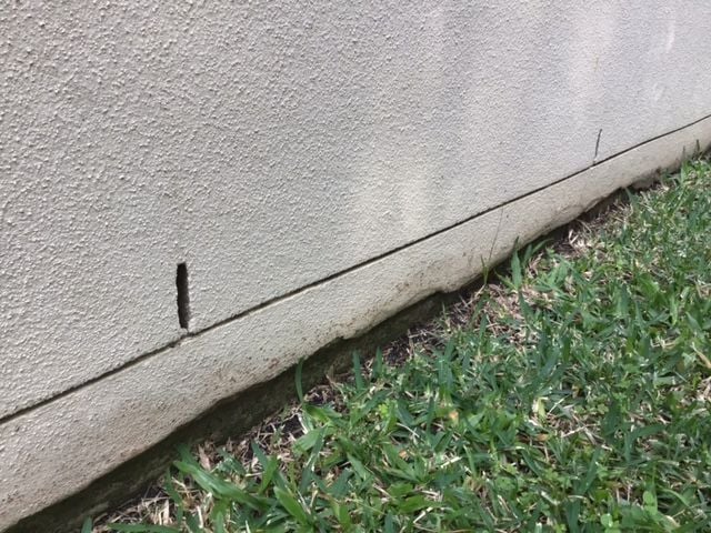

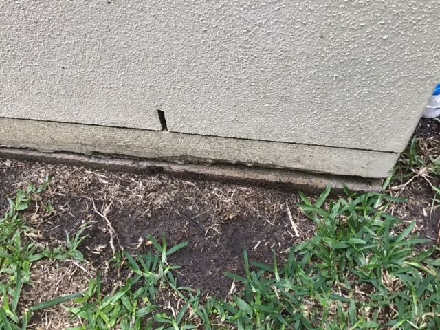

I've recently bought a house that has some signs of wear around the parging.
I've no experience really but my plan was to
-dig a ditch around the perimeter
-scrape and reconcrete/repair where the render was coming off badly.
-fill the ditch in with drainage gravel

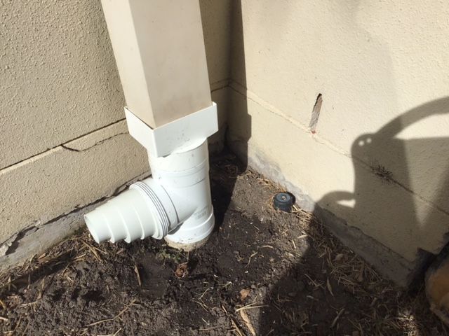

I've recently replaced the downpipe adapters as some had cracks and were leaking. The house eaves are very narrow so i suspect there is excess moisture pooling in this area when it rains and causing the erosion.

Welcome to the Bunnings community page :smile: Id be doing pretty much what you suggest. Tho the last step of filling it in with drainage gravel maybe if I had placed a sleeved corrugated pipe in the trench first? The damage does look like its traveled up from the ground so the water needs somewhere to drain to?
