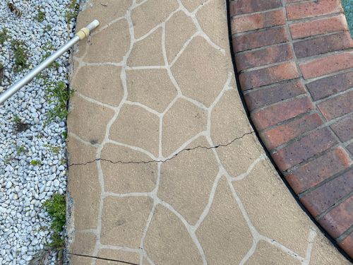

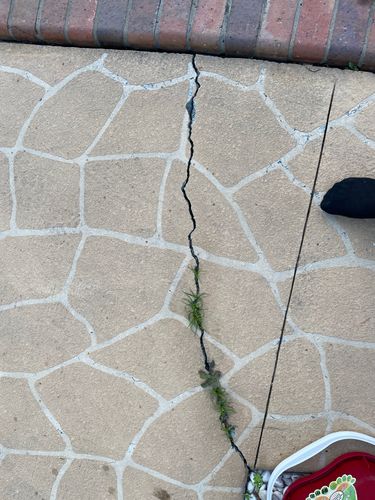

The pool deck gets a few cracks, not sure if there is a similar colour sealant can apply. Thanks.

You could interchange between Sika 310ml White Sikaflex Pro+ Polyurethane Sealant and Sika 310ml Sandstone Sikaflex Pro+ Polyurethane Sealant to mimic the pattern. Fill the "paver" section with the sandstone colour and switch to white for the "grout" lines. Sikaflex 11FC is a flexible polyurethane sealant that should cope well with any additional movement of the concrete slab.
Begin by removing those weeds and any debris that has been lodged into the cracks. Once they are cleared, apply your sealant to the crack with a caulking gun and clean off any excess before it cures. Remember your PPE, including gloves and safety glasses. Whilst working around the glass panel, ensure you don't tap the glass with the caulking gun, as glass panels tend to shatter if they come in contact with something hard.

This appears to be stencilled concrete @Andrew2023, and most paints are designed to go over a bare concrete surface. If you were to paint the area, were you thinking of painting it all in one colour and not having the stencilled effect? I'd suggest giving the two different coloured sealants a go, as the results could be acceptable.
