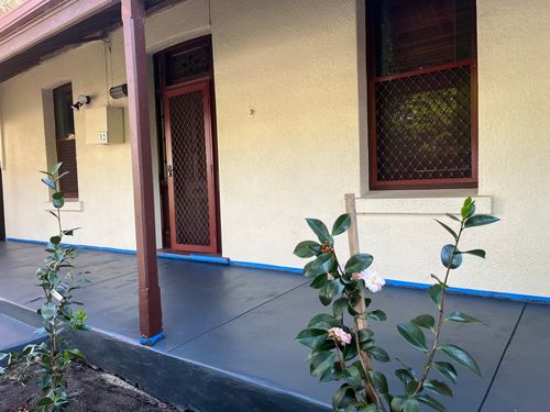

I’m repainting this porch. Old and couple layers of paint.
I have limited resources so diy’ing.
I’ve high pressure hosed it, up to the de-flaking loose paint and sanding it back with hand 120grit sander. I’ll give it a good go-2days.
then I’ll Berger Active Clean it and ain’t with white knight Ultra Pave quick dry 2x coats.
1- image shows close up spot where I’ve sanded de-flaked.
2- image 2 is the area I haven’t sanded yet.
3- is the tools etc.
Question- is this approach enough? I’ve read another post that said wouldn’t recommend belt sander /paint stripper too much labour. But I’m worried about it peeling /looking bad. I don’t really have means to belt sand.

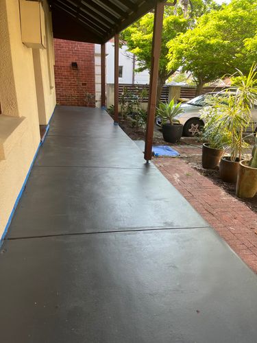

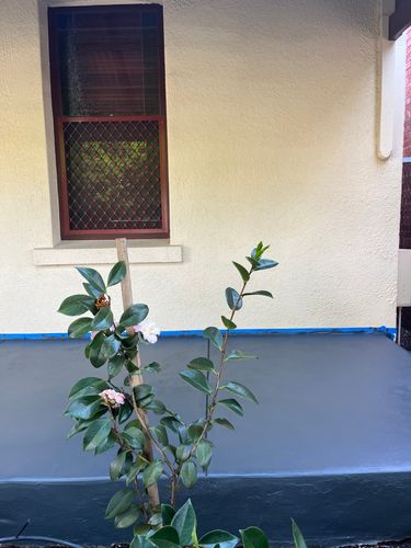

Thanks Mitchell for your advice. I waited couple of days to paint and it turned out well I think! Few bumps but it’s an old porch with lots of paint layers. Pics attached.

Thanks for your advice- I went ahead with White Knight paint and think it turned out pretty well.

Thank you very much for the update, that porch looks fabulous. The White Knight looks to have settled nicely and has provided a uniform finish. I'm sure @MitchellMc will be happy to see that porch painting project came out very well.
