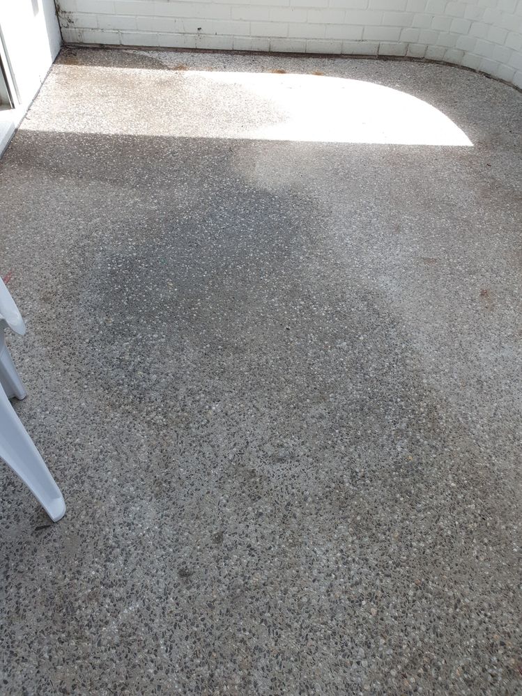

A client had an accident with cooking oil in their alfresco area. They have moved out but there is a big stain left on the exposed aggregate concrete. it has been there for 6 months now and I need a solution to remove it. I have a pressure washer and tried that a couple of months ago along with some concrete cleaner. Does anyone know a solution here? I'm tempted to just put more oil around the whole area to make it even!

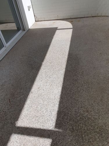

that CLR has to be one of the few products that actually works as well as advertised. I'm a new convert!
thanks everyone! perfect product @EricL   20231218_115932.jpg20231221_101557.jpg
