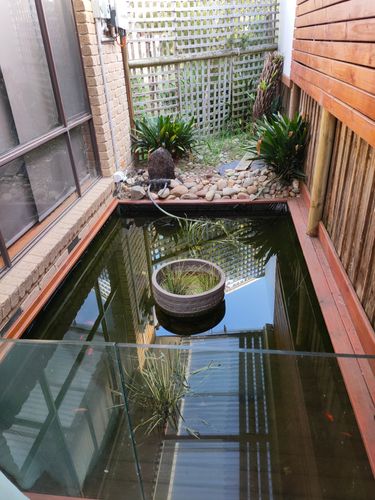

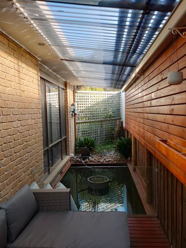

I have an outdoor covered fish pond facing North east, capacity 1500 L.
Could you please advise:
1. A water pump, filter, uv light (all integrated ?)
2. 3 pond lights?
3. Do i need to remove the middle pot and install a new pump there?
4. Im thinking if can fit through central pot water feature
My current pump with small integrated filter (after 2 years) is not pumping water although everything appears to be working. And it was connected to an external UV. Also, my 3 led lights are weakening now, need replacement.
Need to fix this asap as theres 8 goldfish
Thanks
Thierry 

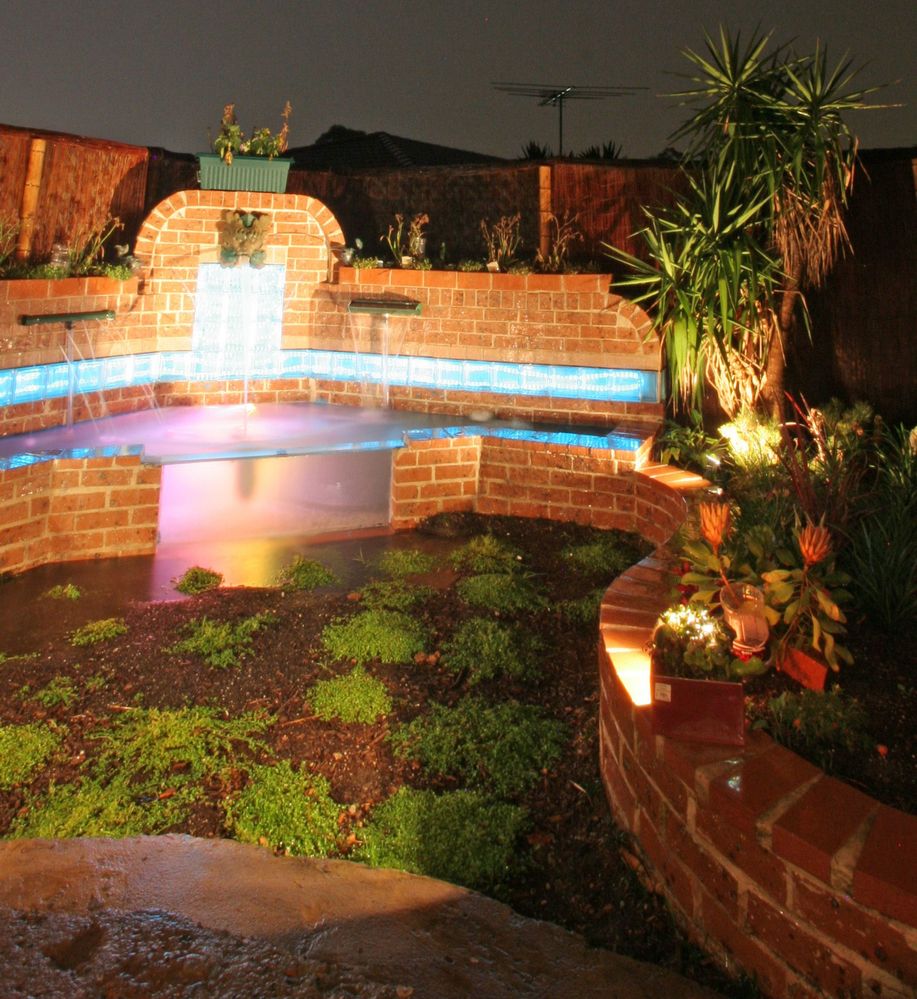

Picture my stage one fish tank with aquarium front.
