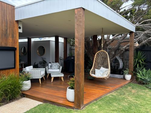

Just to give you an idea of how oil enhances the timber over the years :smile:
I have just gone through doing some annual oiling (yeah id say kinda annual... maybe longer lol) and how it really brings life back to something.
Annual timber and decking maintenance

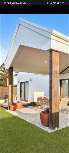

Thanks @Nailbag , @Dave-1  and @JacobZ .
Will be heading up to my local Bunnings this week to get the job rolling. Thanks for your advice and @Dave-1 the refresh clearly makes a difference!

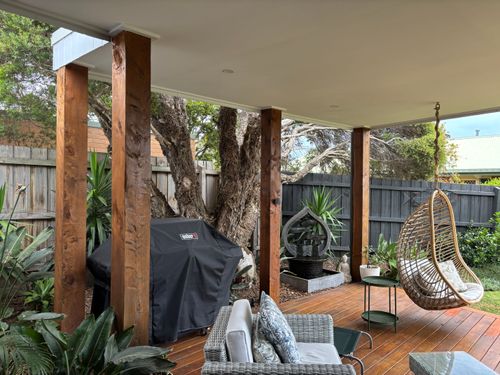

Great stuff @Dliy1 I forgot to mention that I did prep my posts with deck clean as @JacobZ had recommended, which I just use a stiff deck cleaning brush on. Essentially I treat the posts as if they were decking boards.
These are my posts done last Nov.
Nailbag.

They look great @Nailbag .
I finally got around to doing ours and they turned out heaps better than where they started, will probably try do this annually if I can remember to.
